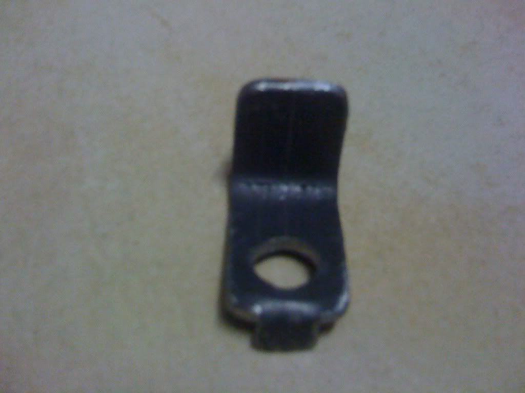

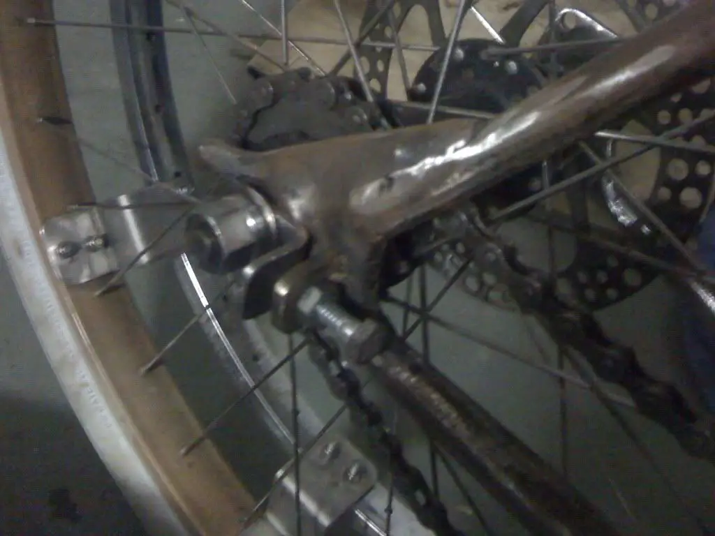

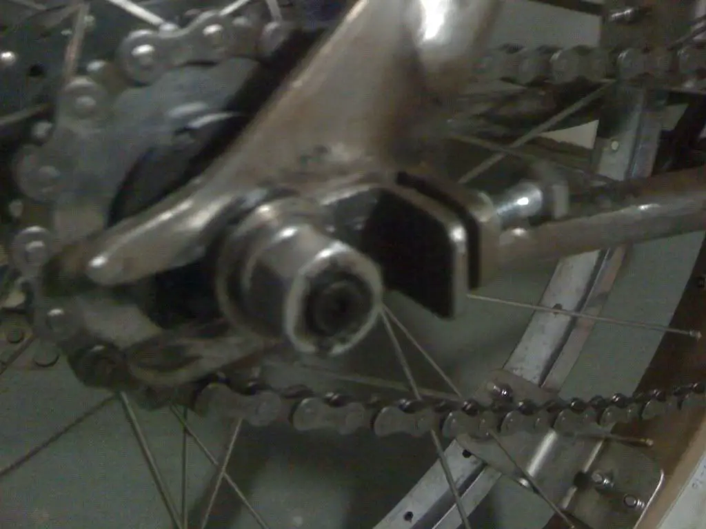

I have pondered a threaded axle adjuster similar to a motorcycle set up, but nothing more. Just pondering. It would be easy enough to add to the drop outs though.
