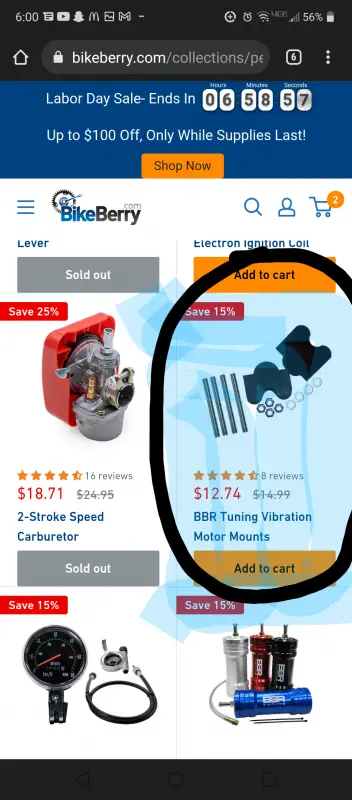

You can buy these "vibration mounts" (they only $12) it's 2rubber pieces that go on top of the front & rear mounts, and comes with longer 6/8mm studs to use when u install the rubber mounts..they work hella good people don't even hear when I pull up or leaving..you won't regret it..
Here's the site :
Here's the site :
thanks those are the one i was looking for
