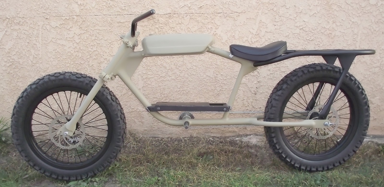

All welding operations have ceased for now. 3 gussets, 2 at the top of my unconventional seat stays and 1 at the top of the seat tube have been welded into place and then bathed in Kevlar laced fiberglass using my middle finger. I think I'd have to run over an I.E.D. to do any real damage at this pont.
The best thing about welding bike tubes together is actually when you are done welding them altogether. LOL
Since there has never been any strength comparison of the 2 bike frame geometries, how would I ever know if the old standard is still THE only standard, regardless of the reinforcements used?
I'm not gonna throw a motor in there and go flat out from the get go. This is gonna be slow and methodical until I know one way or the other.

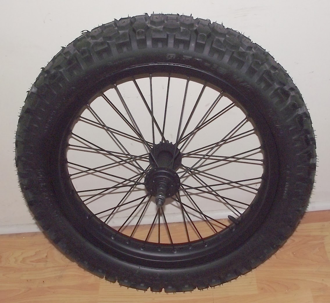

I also have to worry about the wheel axles that are extra long and are supporting motorcycle rims and tires that weigh a ton in comparison to bike wheels and tires.
Axles support the frame,don't they? The axle pushes down on the wheel,the frame pushes down on the axle.
The tires also sends shockwaves back into the axle if you hit something in the road and each tire/wheel combo weighs 20 lbs.

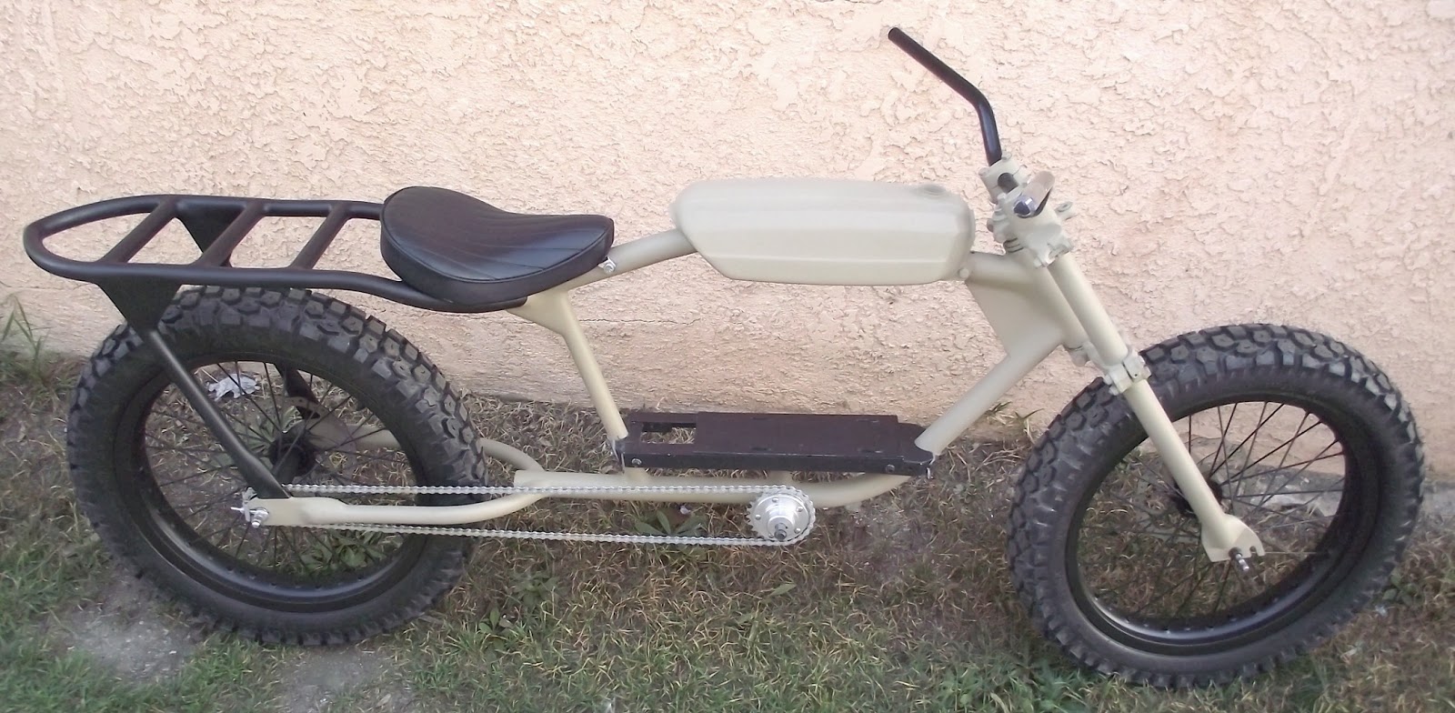

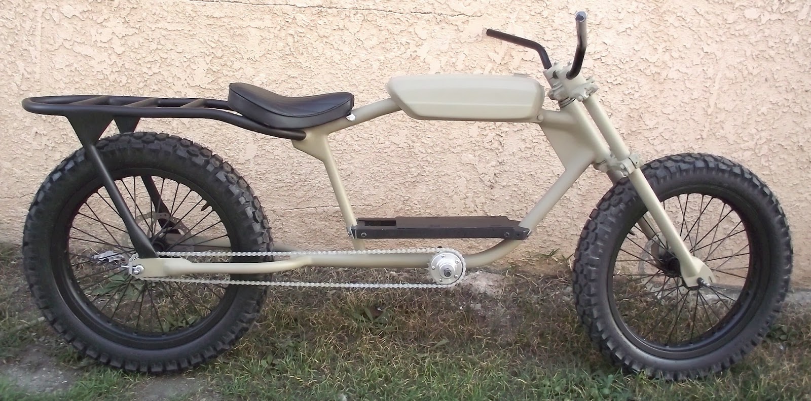

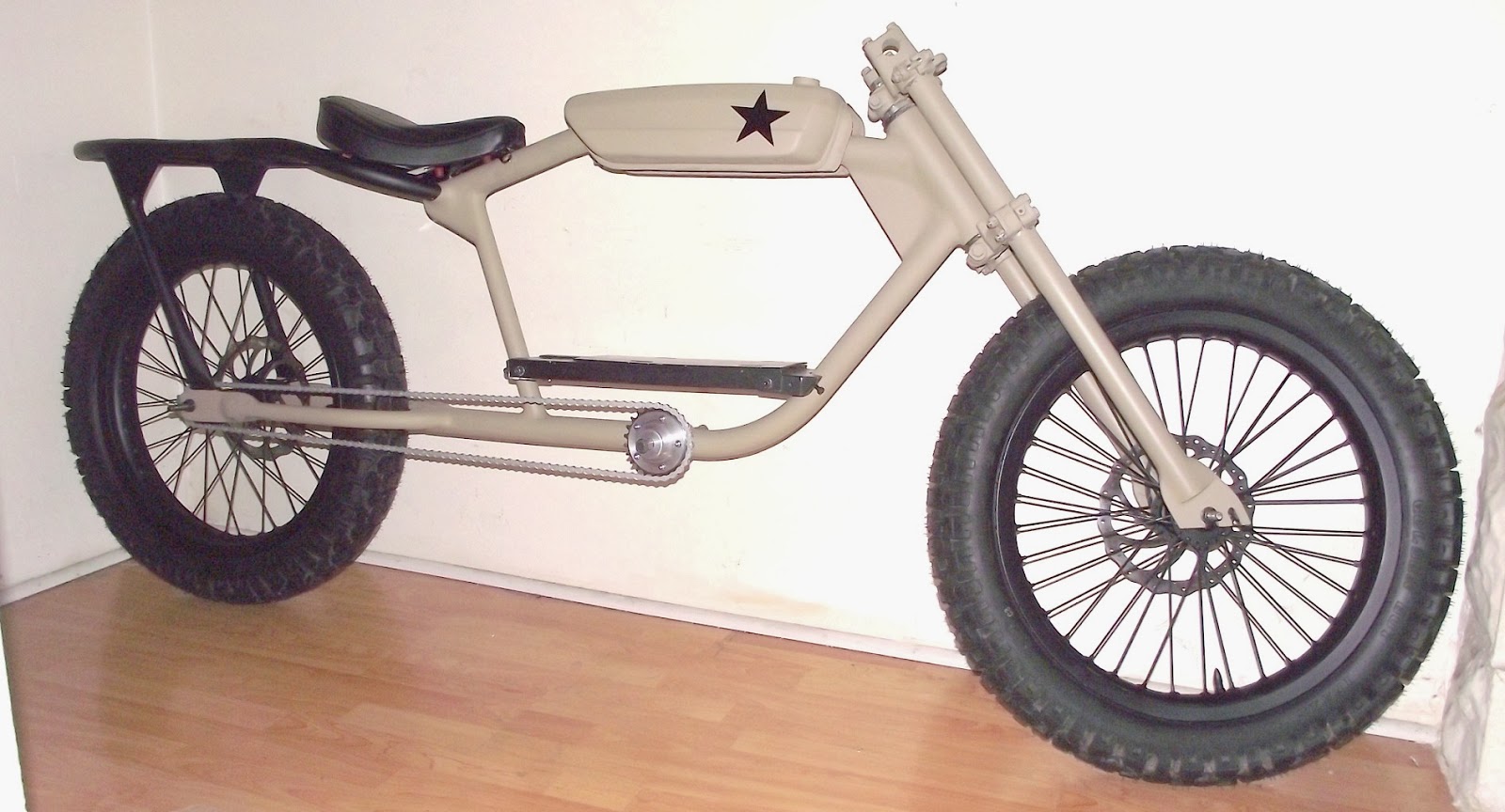

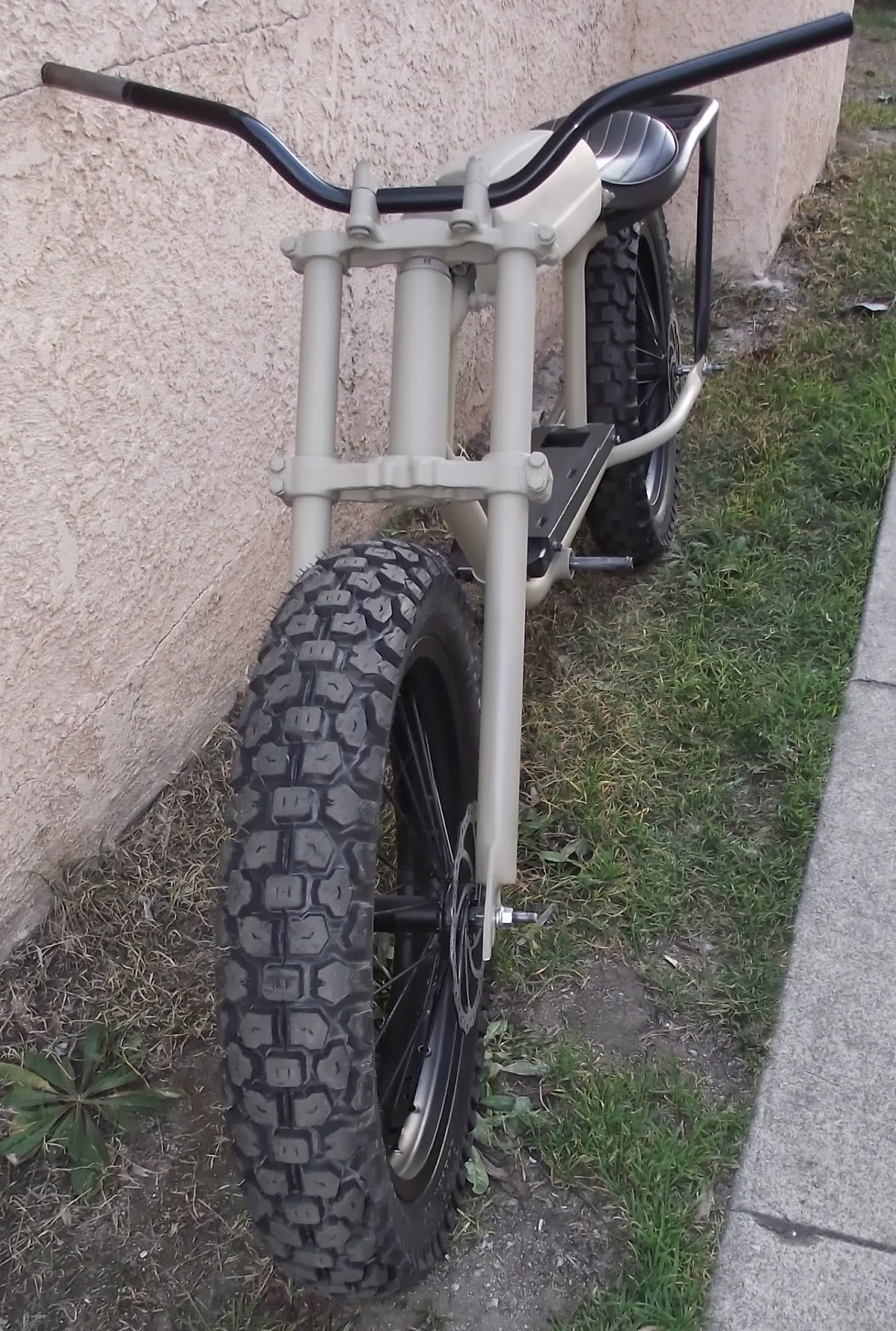

Frame and forks are now painted. Forks were greased and mounted (for the last time). Final weight for frame, forks and engine mount is 41 lbs.
look'in good
mike you're an inspiration
Thanks Buba. Let your mind soar.
I can't possibly imagine any of these tubes moving 1 millimeter. Even minus the conventional seat stays. It's been reinforced 6 ways to Sunday. Not even L.A. streets are enough to do it.
The motor mount itself acts as 1 giant brace holding the frame together.
I can't even feel those tires enormity at their max 32 PSI. The feel just like regular bicycle tires do really. I'll be riding at about 20 PSI though, for my spinal cords sake. LMAO

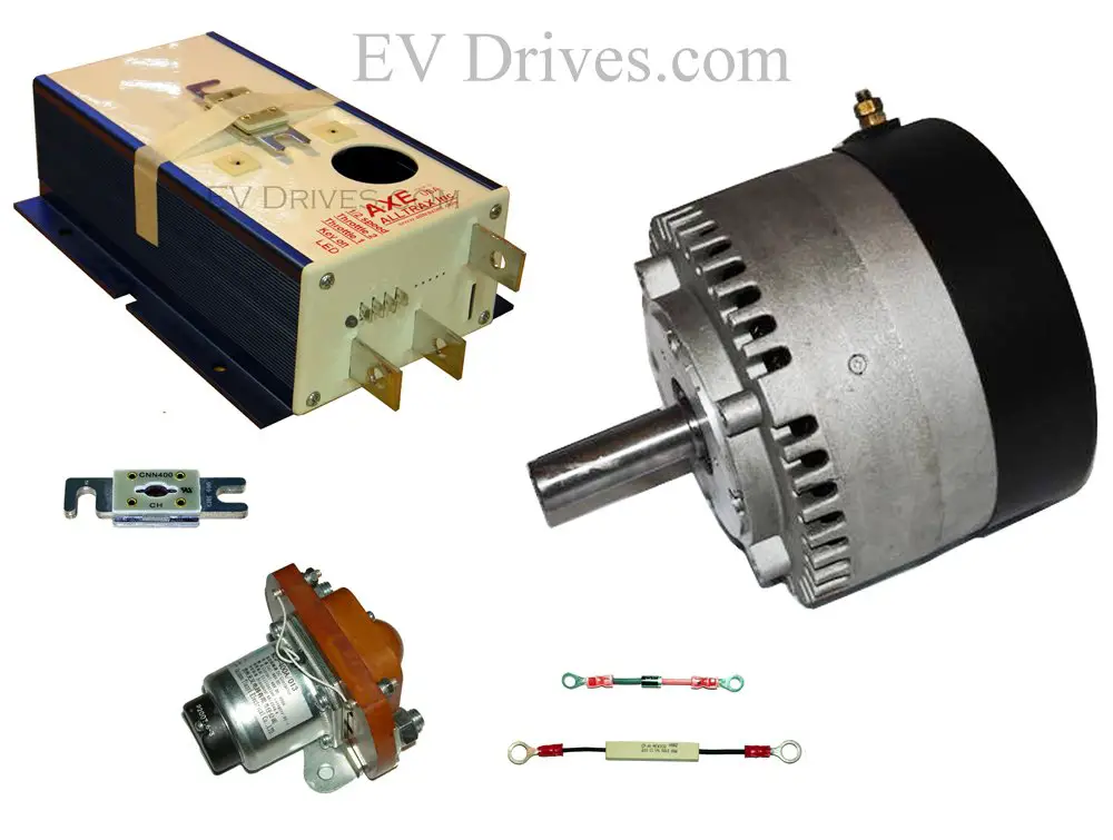

Now you grabbed my attention. :) What's the game plan? Mid or hub motor, watts and volts?
No hubs. I'm done with them. I'll be using a 8" Motenergy / Etek PMAC-SS motor at it's maximum continuous rating of 7.2Kw, 100A, 72V, 22 lbs of terror, on a 16Ah battery pack.

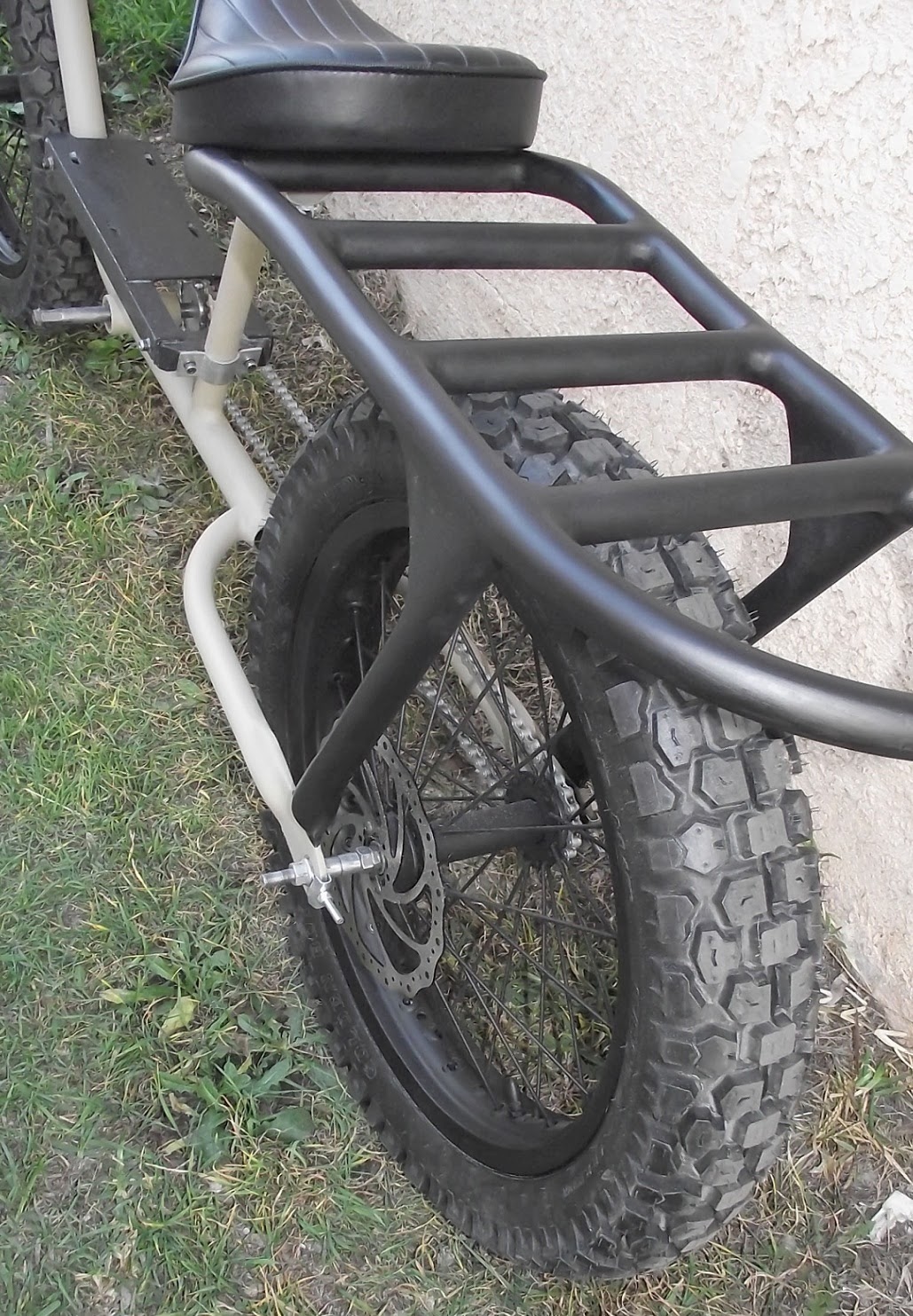

Two of these, welded on each side of my rear rack. Capable of holding 8 vertical Zippy's and all it's wires and cables inside of flame proof vented boxes.
