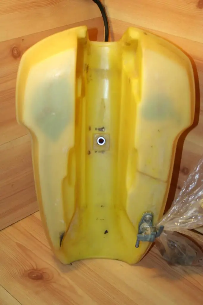

I think this would look good but its out of stock. Could email Treetland and see when theyll be back in. https://www.treatland.tv/puch-ranger-red-gas-tank-p/puch-red-ranger-gas-tank.htm Searching mini bike tank on ebay i found several like this un. http://www.ebay.com/itm/1973-Honda-...Parts_Accessories&hash=item4607620512&vxp=mtr
The puch tank has some advantages over the ebay honda tank
1.No rust in the tank
2. No time and money to restore
3.It's rear mount is higher. On our Honda tank, I had to cut off the rear mount to reposition it.
But I see some disadvantages with the puch tank however
1. Gas cap? if it's not included, how much to buy?
2. How will you mount it in the front. I think I can see front mounting slots in the 2nd pic. If they are, how do you get the rubber inserts that would likely slot into them.
3. At 19" long, that's a awfully long tank for most bikes. You might want to do some kink of makeshift mockup to make sure it's proportion's have a look your ok with.
