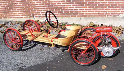

What I am up to is building a somewhat modern version of this
I have a 4 wheel recumbent style, something like a Rhoades car but in my eyes better looking,
I was going to use a swing rear from a mountain bike on the rear for my 5th wheel,
The side weight bias within reason will not be any issue in my case,

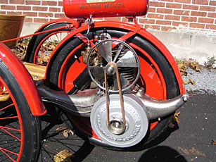

I might add the the day the motor wheel was also used on the rear side of a two wheelers making an odd trike
