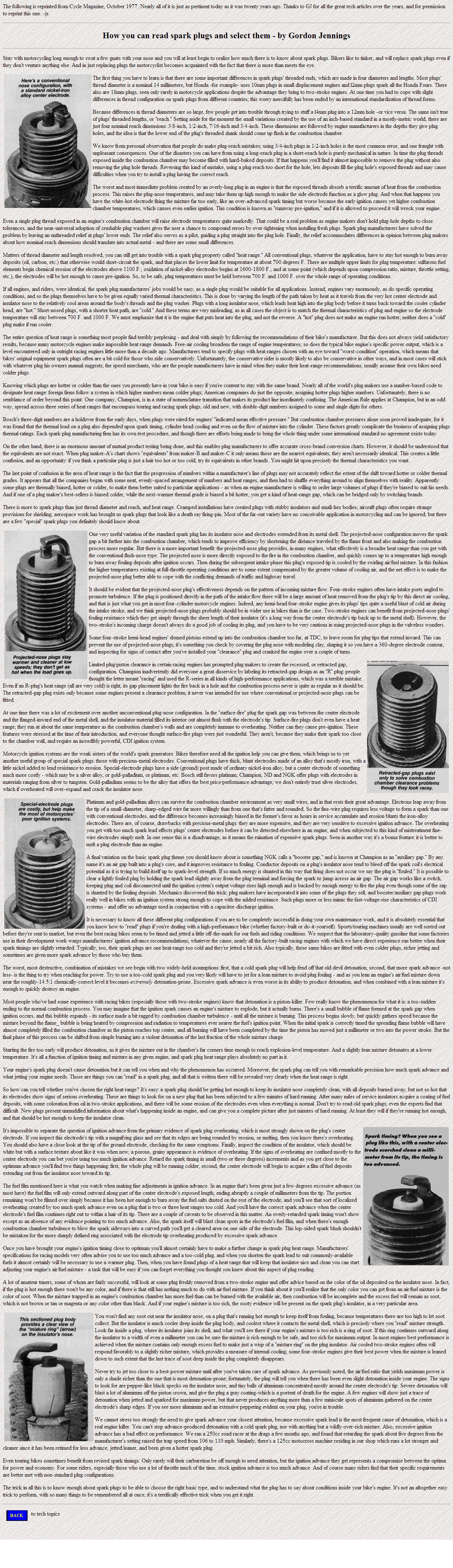

An idea came to me about the plug forward/backward thing. The exhaust side of the head always runs hotter, so if the plug threads are over there, it will run hot. Why not try plug forward with a colder plug?
Too much snow for me to ride lately, so someone else try it?
Meanwhile, some good plug info:
