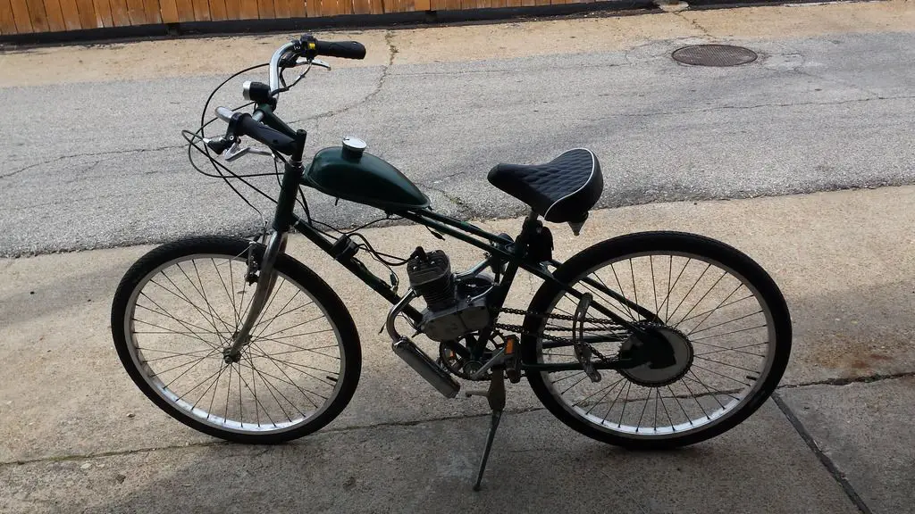

    Replaced the chain with a #41. I'm still am getting used to the clutch but I call this bike finished (for the moment)[​IMG]
  10. 2door
    2door Moderator
    Staff Member
    Joined:
    Sep 15, 2008
    Messages:
    16,308
    Likes Received:
    30
    That frame is just too cool for school. I love the way the lines flow on it.
    That bike came together so nicely. Congratulations.
    Just curious,cuz, are you pleased with that chain tensioner? Did it need any work to align it with the chain? Also, did your kit chain actually break or did the master link fail?
  11. thxcuz
    thxcuz Member
    Joined:
    Jul 26, 2012
    Messages:
    290
    Likes Received:
    The kit chain broke. The master link was still connected. I added a few washers and a longer bolt to the tensioner to align it better. Since this is my first build I have nothing to compare the tensioner to. I knew I didn't want to use the stock one. I.originally got big fat tires for the bike but there were Hella clearence issues so I uses some skinny 26's that I had. It doesn't look as nice but it's a lot less hassel. The frame was designed for skinny tires.

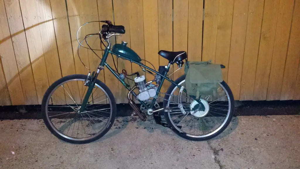

    I think I'm calling this project finished. I added a suspension fork and a calmshell. Plus a rack and some bags. I upgraded the throttle because the stock one was a little wobbly. It makes quite a difference. The fork smooths out the jerks a lot. I would still like to upgrade to a bigger tank. Not because I need more gas but because that dinky peanut tank just looks redonkulus.[​IMG]
  15. mapbike
    mapbike Active Member
    Joined:
    Mar 14, 2010
    Messages:
    5,380
    Likes Received:
    Bike looks excellent..... I liked it before you even started and I like it even more now....
