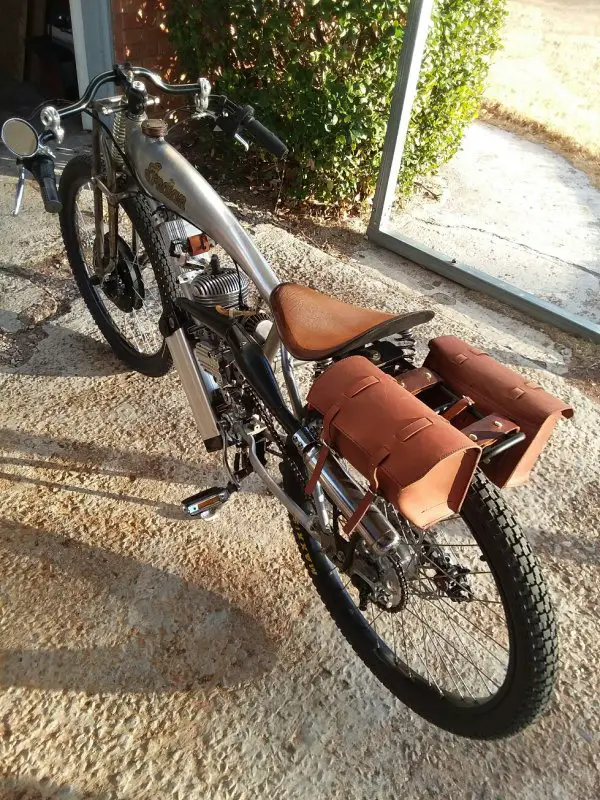

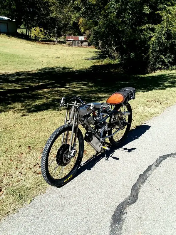

Long rides require a great deal of preparation. The bike I rode has thousands of miles on it and many modifications along the way. I trust it to get where I'm going and back because I know it's built correctly. It's a hybrid electric front hub, with a 66cc China girl that makes about 5.5hp...dependably. I've built 66cc motors that had a lot more power but weren't fun to ride day in and out unless they were ridden flat out and that's not the way I like to ride anymore. I'm an old guy lol. This one always starts and doesn't, too much, mind going 10 or 15 mph in town with a 36 or 38 tooth road gearing, but 44t around the city would probably suit it better, but I use the electric for the really slow going and all starts and take offs so even a 32 tooth on this would work in town. I still wouldn't ever have to pedal.
Photo taken along the way during the 500 mile ride. Only problem encountered was a broken pedal chain and some cold weather on the last day.
If you ever need help finding good wheels or hubs with sealed bearings and disc brakes front and rear PM me. Glad to help.
Rick C.

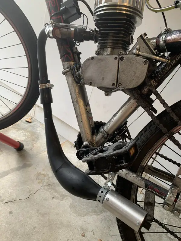

This bike just took some steroids. I added the expansion chamber and I was so not ready for how big of a difference it made. Before the upgrade I could manage about 23mph going up this steep hill with my 32T sprocket but after installing the x chamber it was doing 35mph!! The bike bolts forward when you twist the throttle. I haven’t tested top speed yet because traffic is bad right now, but considering it was doing 35mph up a hill, I’ll easily be beating it’s previous top speed of 38mph on flat ground.
This thing just got way too fun. Now I need to upgrade the hubs and tires so I can take advantage of the speed increase
