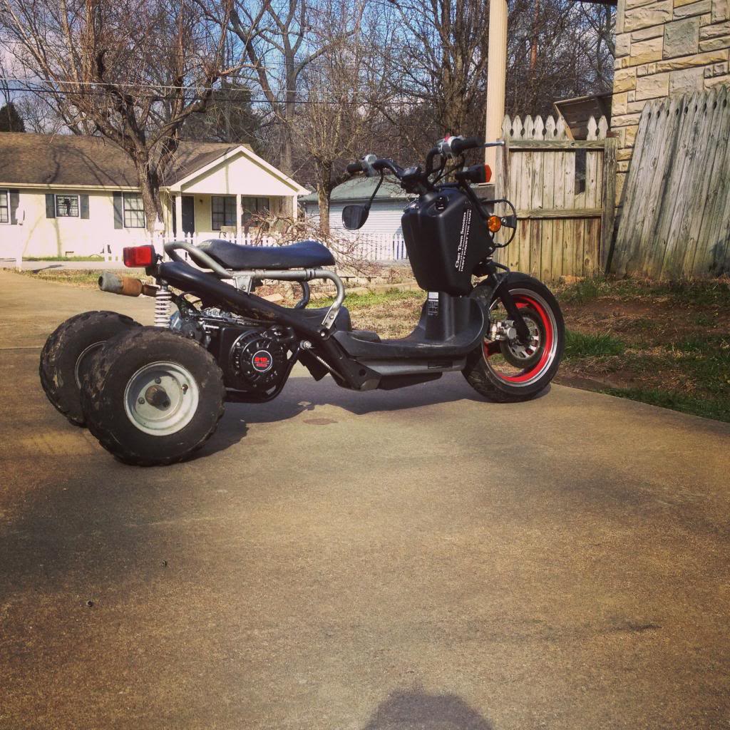

Found this frame for $5 and I started thinking if it were possible to build with a HF engine.  Don't see how to mount a rear wheel.
	The scoot original had a GY6 power unit with the engine being unitized with the rear wheel and suspension. These units are excellent clones of the original Honda designs and can be modded with readily available speed parts. All that being said if I were gonna mod it for an HF engine I would simply fab and weld some brackets to accept pillow bearings for a rear axle and wheel. doesn't look too hard. This would make a rigid rear suspension(the simplest way) but maybe a sprung seat could be added. Looks like a blank slate and an interesting project!
