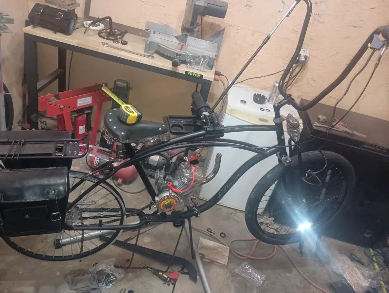

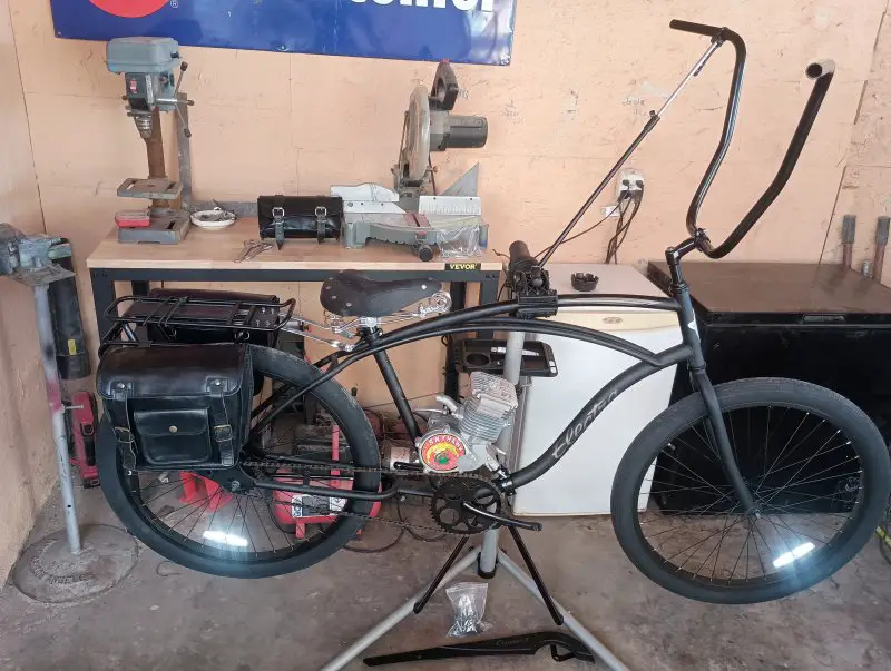

Well After being busy the last month I finally got to work on the bike some. Mainly Just got the new fork/stem/handlebars on. everything else was me just setting things in place, checking clearances and ordering parts lol. (wide crank, gas tank, cnc throttle, tubing to make an exhaust, etc etc)
Being the holidays I may not be able to work on it much until January sadly.
Edit: aye anyone know where grubee get their rims? (Ordered the rear rim with HD hub and sprocket from them) Might have to email them. Kind of want a matching rim for the front. Planning on getting a new front rim anyway so I can get a hub compatible with disk brakes.

My advice... You should stick with the stock pedal crank....the wide cranks suck & aren't needed for that engine.
If the pedal touches the engine on one side, you can simply add (or remove) a large washer between the bearing parts & the crank to center it up.
Next... The very first things I do when building a new bike are to mount the engine as solid as possible, then install the rear wheel (with the sprocket you're going to use).
Next... install the clutch lever & cable. (this will help you install the engine chain).
Next... with the cranks & pedal chain already installed, you can install the new engine chain & chain tensioner.
My problem is while It just barely clears the engine, with the way the crank, motor mount, etc sit there's no room for the exhaust pipe. couldn't even dry fit the stock one pointing down. Even though I'm going to do a custom exhaust the tolerance would be really tight, and I'm not THAT confident in my pipe bending. The other option would be to loop the exhaust over the top of the engine and back down. Like I put in my original post I'm aiming for something similar to this.
If the wide crank irritates me too much I can always swap it back to stock and loop the exhaust over the top instead. custom exhaust is one of the last things I plan on doing in the order of assembly anyway.
Besides the crank, I already have the rim with HD axel and sprocket dry fit. Waiting on a freewheel sprocket for it because it didn't come with one so I haven't bothered putting a tire and tube on it yet, and a chain breaker because I did set the 415 chain in place to check fitment and I need to remove at least 7 links. Its way to long even with a tensioner and I'm not interested in extra chain flopping around effing things up lol

If you're planning on fabricating a full custom exhaust to fix the clearance problem?, it would be way easier to simply modify the stock exhaust.
There's lots of easy little tricks that I use for that.
Get the engine, rear wheel, cranks & both chains fully installed, & then we can come up with a solution for the exhaust! ;)
