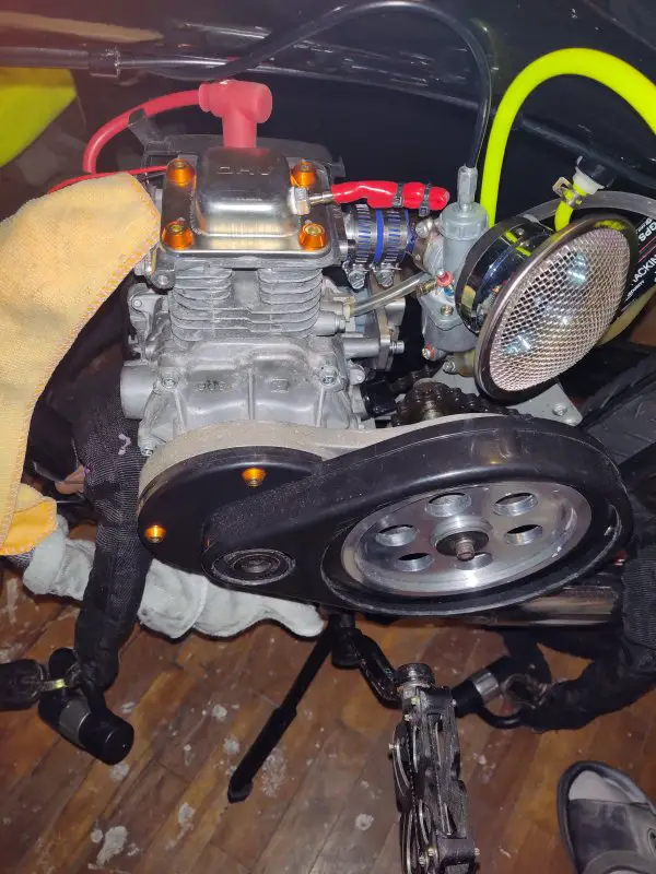

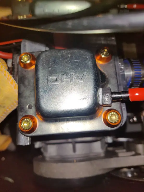

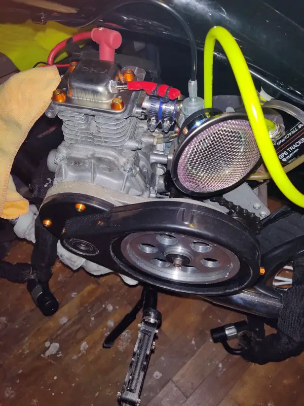

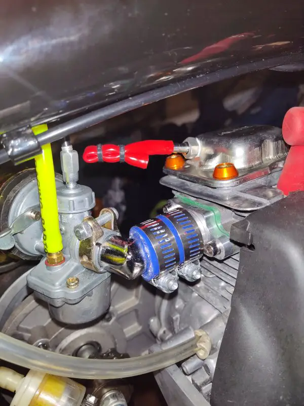

Hi I'm new to this site and I have a question I added this on the valve cover of my
Huasheng 49cc 4-stroke
trying to add a fuel pump and I would like to know if anyone think that this will work?
