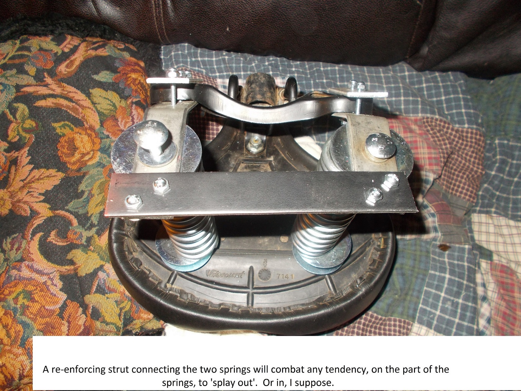

Added good springs to my saddle.
bluegoatwoods
This could be useful for anyone who wants to soften the ride.
I got a set of 'porch swing' springs from one of those warehouse style home improvement stores. About 8 1/2 bucks. They come with a set of 'drawbar' springs inside. But those are easily removed.
A few carriage bolts, some fender washers and nuts will run a few dollars more. All told, the thing can be built for about 10 bucks.
I got it finished this morning and my test rides, so far, have only amounted to a couple of miles. Still, it feels like it's probably trustworthy. And it's definitely softer. Not as soft as, say, a motorcycle with true rear suspension. But it feels as if I'll be delivering fewer shocks to my rear axle, the chainstays and my lower back.

I also considered using the shock from a full suspension mountain bike. Either Wheelbender or Xseler (I can't remember which right now) has built one that way. And I liked the look of it.
But I think I've found an advantage over that design; my only mount point is the seat post itself. There's no need to mount to the frame below. This'll make seat height adjustment, or swapping seats for that matter, a lot simpler.

I actually had this in mind from the start.
But I test rode first. That's when those first pics were taken.
But I think this is important, too.
That's the first ''long travel'' suspended seat I have ever seen.
