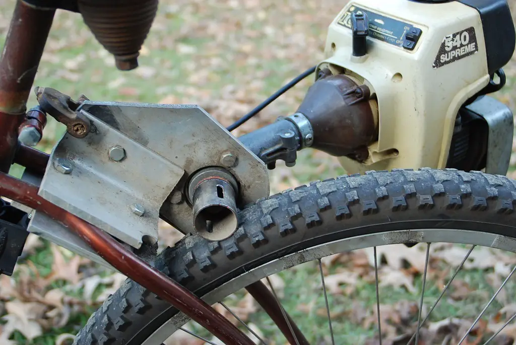

Hey Kevin, It looks like its dangeling but it's proven itself pretty solid. I've used it successfully on 3 or 4 different projects.
The first bike was my daughter's 20 inch bike. That's where it was proven to be reliable. The kids rode the daylights out of that thing for 2 years, till they wore out the bike. Used it on several other projects, never had ANY trouble with the engine 'cept for a couple of carb rebuilds
I'll re-post some more pix in a while, my net runnin slow right now

Beyond the engineering involved, I wonder how the bike would handle with a frame mounted engine in front of the handlebars. . . Good or bad it'd have to be a unique experience.

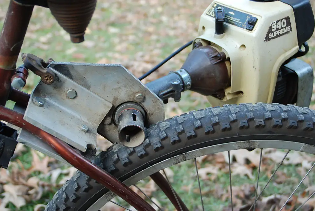

Wayne, your setup is awesome to say the least! It's the perfect way to use the clutch and not have the engine at a 90 degree angle. I'll be looking forward to some more pics. Is that setup hinged so you can get the roller off the wheel?
Thanks Kevin
Yes it's hinged on a single 1/4" bolt,with a beam clamp holding it in positon. I never refined it enough to make the hinge operable with controls.
Here's more pix, but the first one in the other post has the most detail.
