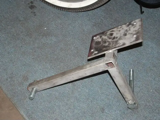

Yeah, "Stude" Here are some detail shots.

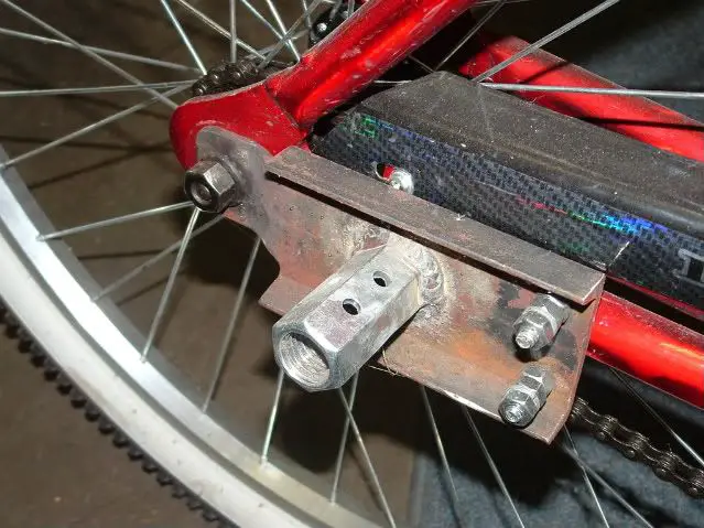

This shot is of the frame mount itself. It is a section of shallow channel iron with a kick bent in one end. Holes were drilled for the axle and for the "U"-bolt. A 3/4-inch double nut was welded to the center of the channel iron. The nice part about this mount is that the bike is not modified in any way, and in 5 minutes it can be removed.

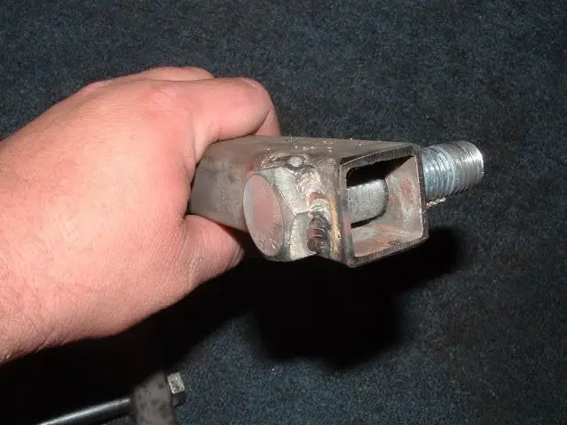

I tore it down for prep and paint. The powered wheel came from northern tool. It had bearings and a sprocket installed when I purchased it. The axle is a 3/4-inch bolt. The pivot bolt is also 3/4 inch.
"Filipino" If someone want's to steal the drive unit by removing the pivot bolt they are a better man than I. Wink Wink.
The pivot bolt is welded to the motor unit and the Double nut is welded to the frame mount. The "swing" action is the bolt and nut screwing and unscrewing ever so slightly.
The boreem style scooter would be a perfect donor. Gas or Electric.
I thought and re-thought and then thought some more to simplify,simplify,simplify. I didn't want to use 5 parts when 3 would do. I subscribe to the "less is more" school of design. I like the super clean look I ended up with.
