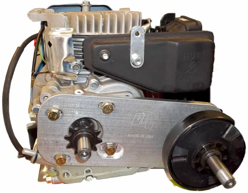

I like the GTC jackshaft. Ever thought of using a Doodle Bug clutch as shown by the GTC? I believe it uses the same 98cc engine.
http://www.ebay.com/itm/Doodlebug-M...508?pt=LH_DefaultDomain_0&hash=item2a1ca72914
http://www.ebay.com/itm/CLUTCH-97cc...238?pt=LH_DefaultDomain_0&hash=item5d33e53296
