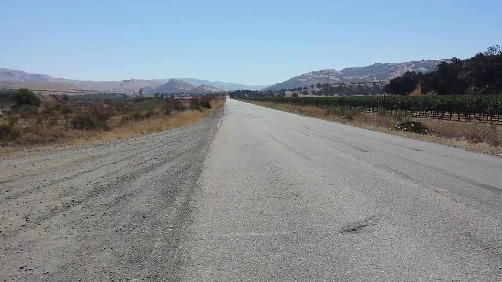

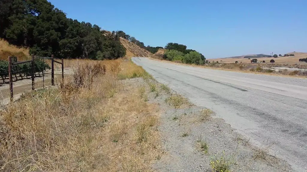

I have been hard at work testing one of my bikes lately. I make one change at a time, then haul the bike out to a fairly quiet stretch of road to see if it's faster or slower. Finally getting it pretty well dialed in. The bike is a Keystone variation on a Bonneville Flyer. Engine is a GX200 stroked and bored out to 234cc. I have been running on gas as well as methanol. I set a goal of 86 mph mostly because I felt the bike could do it and finally it has! Please keep in mind this bike is built for speed. It may resemble a motorized bicycle in some ways but this is a purpose built racing motorcycle. It is an entirely .120" wall DOM steel tube frame running motorcycle tires and wheels. It also has steering stops for limited steering angle, a steering stabilizer, and H speed rated tires. Speed was verified using a quality GPS speedo.
Hopefully these are video links I am adding here. If not just follow the links to my Flickr page.
86 mph by Pat Dolan, on Flickr
