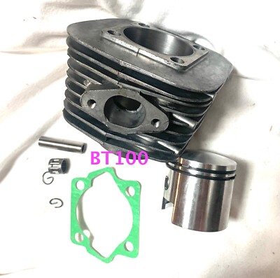

Has anyone Though about building a 80cc engine from a 40mm stroke engine? I saw a piston cylinder and rings with gaskets on ebay, 50mm bore that BGF says will work with a standard 66-69 cc head. If I had a 40mm stroke engine I would give it a try.

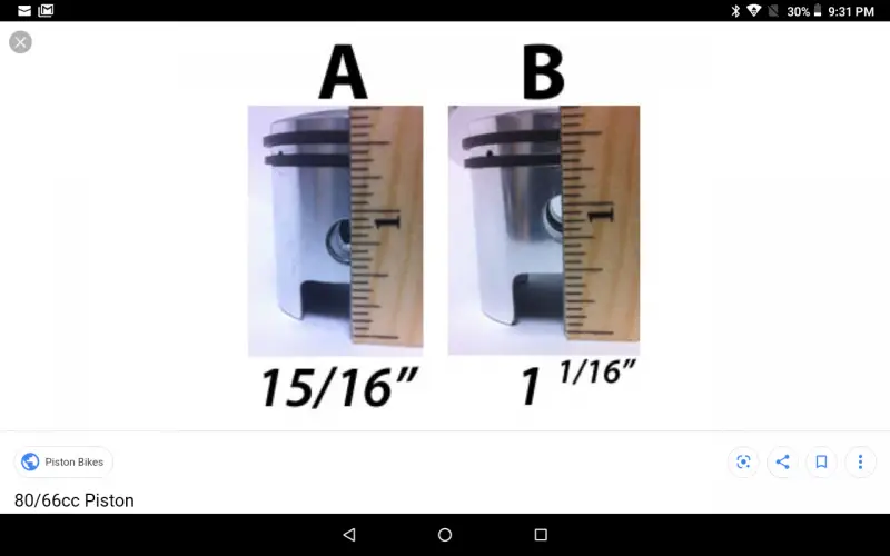

I know I built a 70cc from this Athena cylinder kit with a spacer from smolik performance :)
Spacer 40mm or 38mm
My build
Butttt my build 70cc where did u find the 50mm bore can u give me a model name and link please

My 66cc engine has 38mm stroke, the kit is for 40mm stroke engines, this may be a better way to get a 50mm bore engine to perform. With the heads available and the ability to adjust squish this shows promise.
