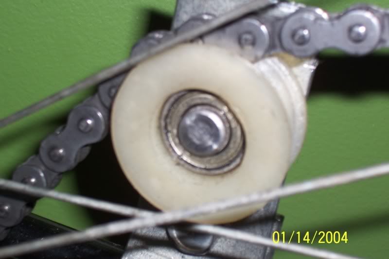

I also swapped the cheapo tensioner pulley for one from DAX....seems to be really good compared to the one that was supplied with the kit. Worth the money to me.....
