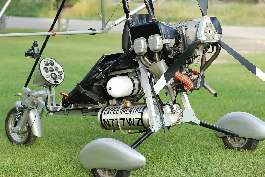

Okay, here's the pictures I promised. One nice thing is the idler pulley from the belt sander rides on needle bearings.
I would take that bottle and chuck it in a lathe or jigged drillpress and sand it while spinning down to 120 grit for a nice machined look, then immediatly de-grease with carb cleaner, and clearcoat it with clear engine enamel from NAPA.
Finished my dunebuggy tanks on my experimental trike airplane like that 6 years ago, still lookin good.
Wayne! I am building that! Well, a boat version that don't look near as well made, snork. But a flying MB/trike/boat.
Now I just gotta learn how to fly. an' weld better and live threw crashing to the earth in flames. But aside from that, I'm golden.
