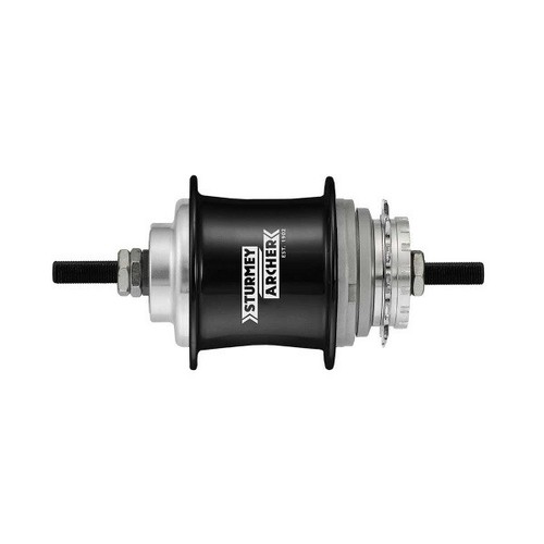

Your ideal setup would be to get a fixed geared IGH for a jackshaft transmission and run 11/36;14/56. This'll give you the following reductions.
1) 17.45:1
2) 13.09:1
3) 9.82:1
Get a tachometer. If at WOT you're going over 4000 rpm shift to a higher gear. If at WOT you drop below 3000 rpm shift to a lower gear
1) 17.45:1
2) 13.09:1
3) 9.82:1
