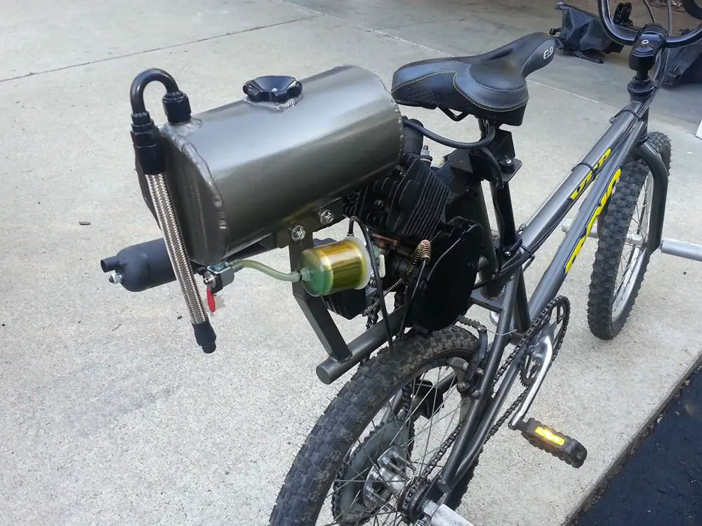

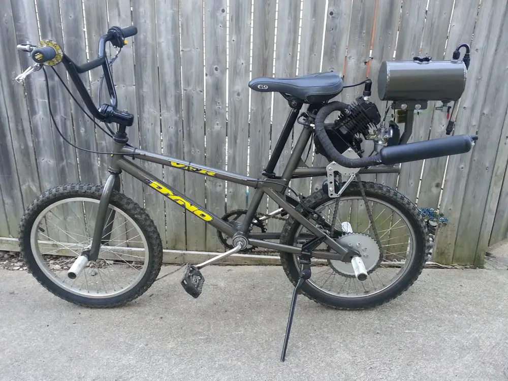

Has anyone ever tried using Timeserts to for added strength and support for the exhaust? I'd rather try something like that before a brace. I got some 6mm Timeserts in yesterday for a cylinder head project for my car, and I believe I'll have two left over.
Also, since the last time I was on here, I built a new fuel tank. Made it from scratch. It's aluminum and the capacity is roughly 1 quart. I didn't like how the original one sat so high and out of place. This one is laid down and sits about 6 inches lower. I also added a nice engine mounted chain tensioner. It was constantly jumping teeth without one.

It rides well. I'm a big dude, so I got to put alot of air in the tires every outting though. Top speed is 20-22 mph with this sprocket. And I've decided to not try to make it go faster. For a BMX bike with little 20" wheels, that's quick enough for me. :)
