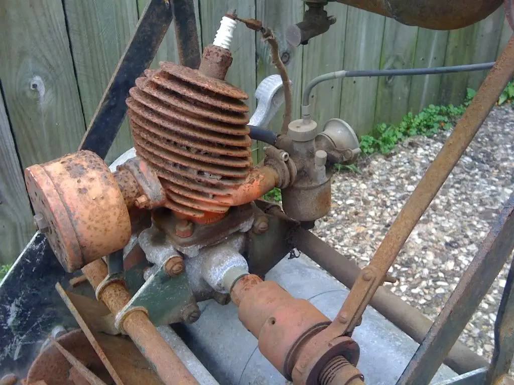

Heres my other spare Villiers engine
Heres the mower it came in

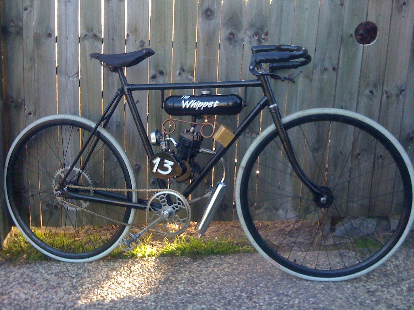

Heres my previous build using the same 98cc Villiers

your earlier 98cc has a great patina.
have you clear lacquered the frame?
what did you do with the rims? are they painted or what?

The frame was stripped to bare metal and left to rust and when i get the desired patina i will just keep the frame oiled..... its nice filling my tank with no fear of damaging the paint..... maybe one day ill paint it the same color as i painted the rims, but for now im happy with the old ratty look...... Its fooled a lot of people. I have a lot of elderly people asking me if this is a genuine "old" bike. Im guessing these older people saw bikes like this in their youth?

The wheels were a secondhand disc brake, single speed downhill wheelset i bought off Ebay, i just put straws over the spokes and sprayed them with White Knight "Mocha" color

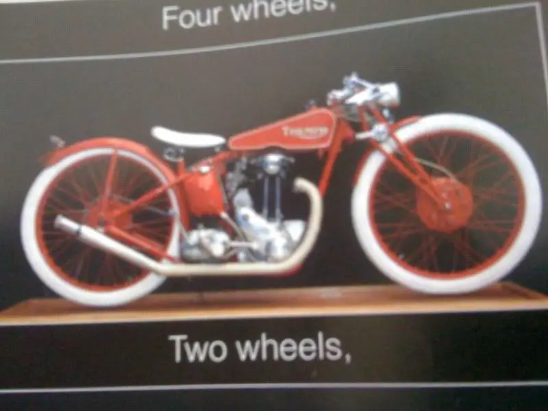

Thats nice..... this is nicer IMO, and would be cheaper to build and its from Australia. I want to do something similar when funds permit
