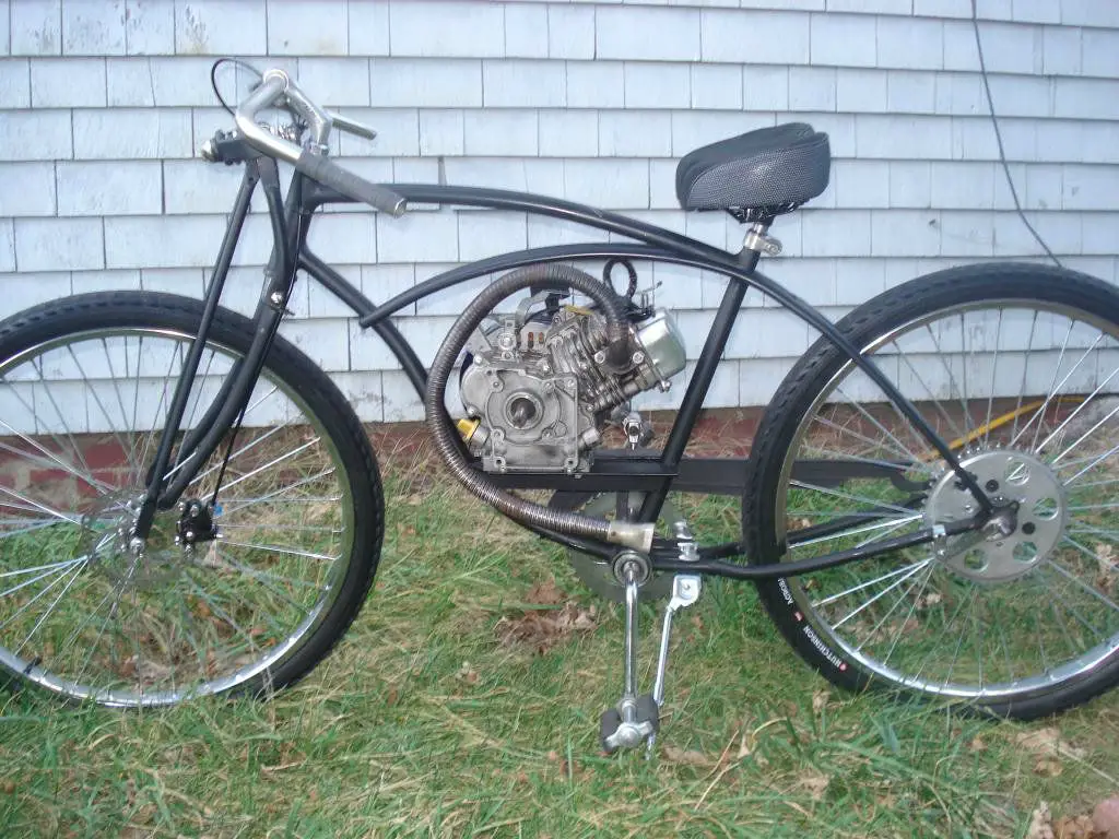

here is a pic of the bike i have at home,
got rid of the seat and the springer fork, bought a monarch double springer fork and a saddle from j&p cycles. have a 48t pirate cycle sprocket with the adapter. also have a 79cc HF greyhound but am thinking about maybe going bigger.

What do you hope to gain with the bigger engine? Also remember that a bigger engine will put more stress on the bikes parts.
Power
The bike will be fine, American craftmanship, 12 ga hvy duty wheels, monarchs ( obviously not installed yet) he's using good parts. Not sure if something bigger will fit without cutting out the mounts you have.

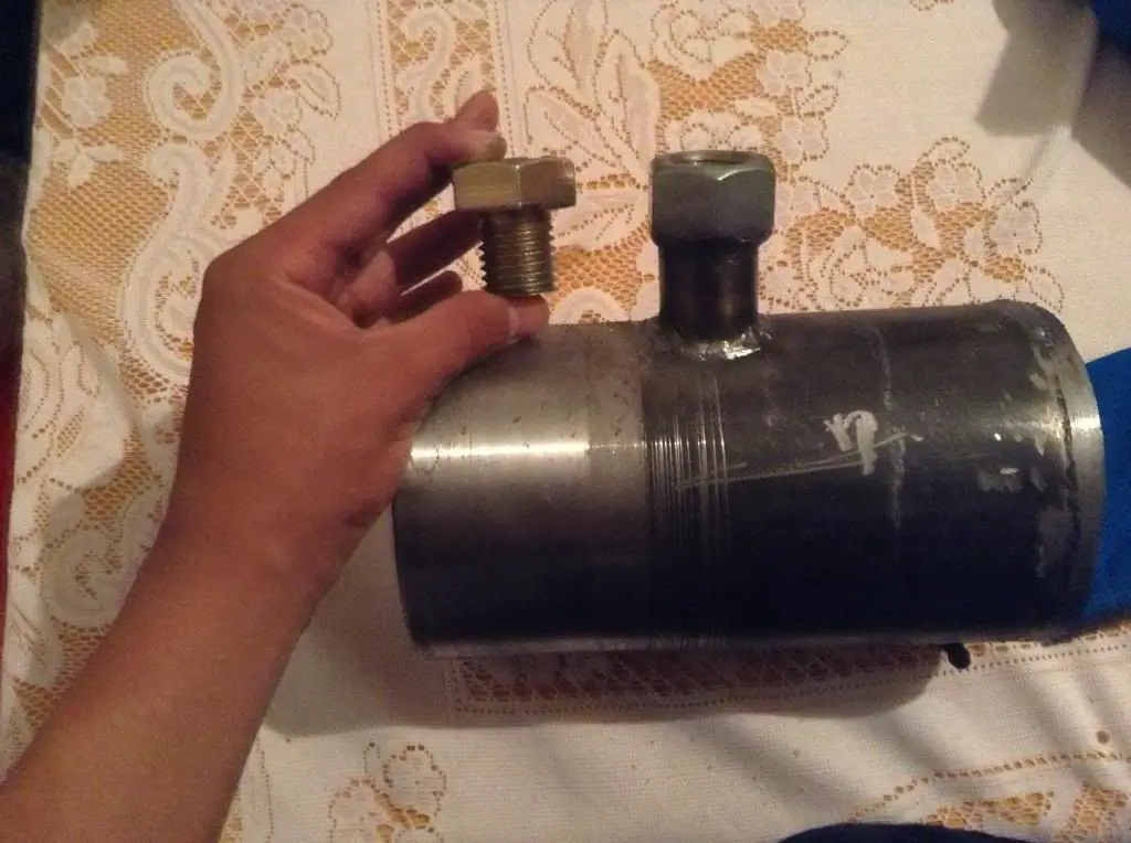

Fuel tank i made before it got soldered, need to sand and put a clear coat on it.
jack shaft from AGK, just need a clutch(11t) when i put that on with a 22t input sprocket and a 9t output sprocket and 48t rear sprocket total 1:10.667 gear reduction ratio.

i know i haven't been on in a while, but have made some progress on my bike, here is the new gas tank i made, i thought the copper one looked stupid. will put up more pics when i get home from work
curtisfox
Dec 29, 2008
6,078
4,042
minesota
You could of used a brass garden hose adapter file or grind the pipe threads off and sholder it in, with a nice brass hose cap. Prolly to late now.........Curt
