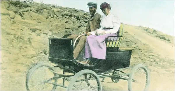

It reminds me of something like this from 1899...
Materials and engineering have made a lot of progress since then and the goal of the customer is to use it as a paid ride at venues or whatever here in the metro Phoenix area, a 'pedi-cab' riders get some exercise on while seeing sights or rides but don't have to pedal, hence the motor help so the driver does not have to human leg power a huge load of people that don't help pedal.
