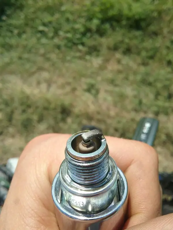

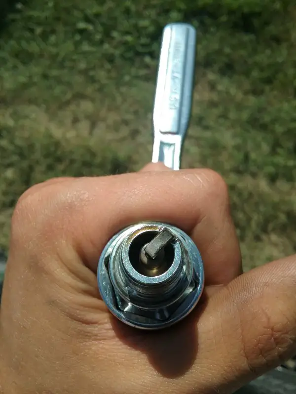

My bike is 4 stroking like crazy. I have tried almost everything to fix it. Changed plug gap, changed oil mixture, changed the jet and needle to the leanest possible (60 jet is the smallest that I have), while it worked for a while it started doing it again (probably because it was colder that night than now), I changed the timing with an offset woodruff key, I switched CDIs, but nothing. One thing that stands out to me is that I got it working pretty well and then it started 4 stroking a lot when I tightened down the air filter tighter than before I might loosen it a little or find a less restrictive one but I ran without a filter and it still 4 stroked. Here is the spark plug after a few WOT pulls with 4 stroking. It looks rich to me and the engine stays really cold even during hard pulls. It usually stays between 120-130 degrees celsius and after hard pulls 140-150. Highest I've ever seen was 160 but it took a lot of WOT pulls. I think either the head gasket or the exhaust gasket is leaking as well. I wonder if that could reduce effective exhaust scavenging or something. I did some pulls with WOT and the spark plug was very dark at the ceramic and the band was kinda grayish. There is also one very noticeable (but hard to see with the angle of the picture) very dark spot on the ceramic portion next to where the spark occurs. Any help would be greatly appreciated. Thanks.

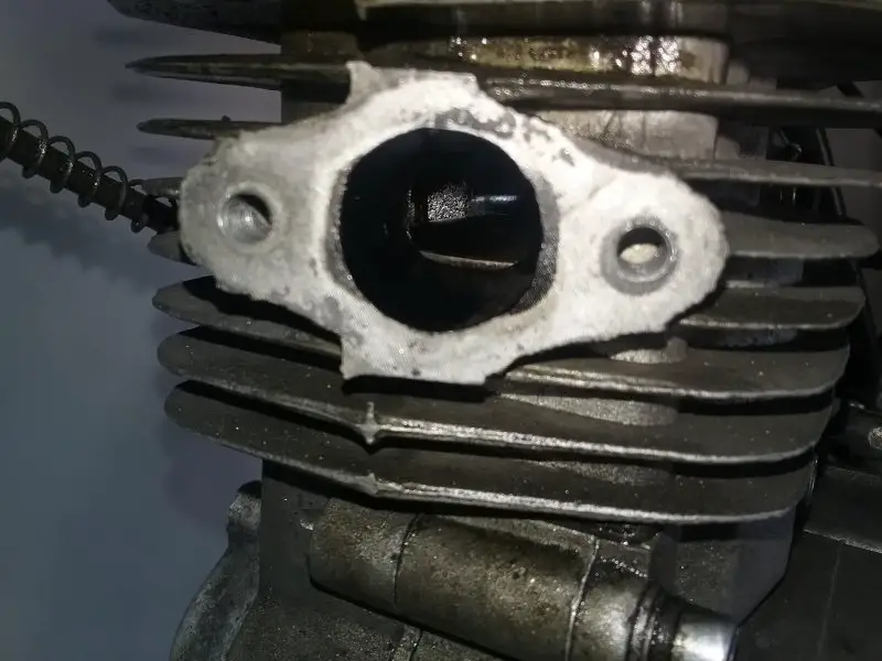

Ok just another update. I found out my exhaust had a small hoke and since it was still hitting the frame it probably didn't make a good seal. Today I fabricated a mounting plate and jb welded (I sadly don't have a welder) it to a pipe. I also cleaned up the very misaligned mounting plate on the exhaust in order to almost port match it. I plugged the hole with jb weld. Everything is still drying and I will jb weld the exhaust to the extension piece I made together tomorrow. I also discovered that the piston still has about 1-3 mm of it still sticking out from the exhaust port. It'll make more sense from the picture. I'm pretty sure that that's not normal. I'll do some research and once I find out that it is wrong I'll raise the ports with spacers. I'll lose some compression but I can always sand down/get a new cylinder head for more compression. If anyone knows if what you can see in the picture isn't supposed to happen, please let me know. In the picture the piston is at bottom dead center.

Is this engine broken in? Have you run at least two full tanks of fuel through her? You changed fuel mix but what ratio is it now running? Are you using premium fuel? Are you living at low altitude or high altitude? You've tried every thing but not jetting under 60? Buy a 50 & 55 jet. Have you changed float clip height? Does the bike four stroke or 4 stroke less with air cleaner removed? Have you tried different, high quality NGK plug & heat range? Stock CDI's (kit and replacements), including wiring are real iffy components new and fresh out of the box. Much you don't seem to have checked to this point or haven't shared the details with us. Like Greg said not to worry with port timing though it can be changed with base gaskets if you like, but remember to change back to stock if the 4 stroke problem isn't corrected, cause power will likely suffer.
Piston crown stickup at bottom of stroke above the exhaust port is normal with stock port timing. Some of us have "ramped" the edge of the piston to flow smoother into the port, but overdone can cause top ring problem...plenty of piston material needs to be above the ring for support. Ramping is not something I'd suggest doing to your engine without supporting power modifications.

Very rough exhaust port timing( porting to better dimensions should help with 4 stroking right? I don't think I'll try it yet unless I want more power later on)
Port opens ~98 degrees from TDC
Port duration ~158 degrees
Port closes ~256 degrees TDC
Port rough diameter ~20mm already relatively smooth
Haven't measured transfer port timing yet so I don't know blowdown.

I was thinking about using the base spacers to have the piston clear the exhaust port completely but I would probably change port timing and compression too much for it to fit my needs. I like fast acceleration and a decent top speed which is how it's running right now. Top speed is about 35 mph without 4 stroking and it gets from 10-30 mph pretty quickly.
