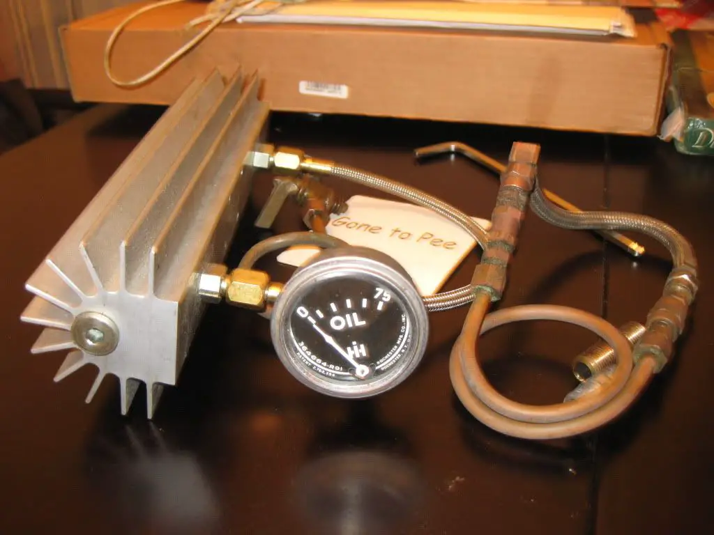

Or you could add one of these.....
I've been meaning to put this little cooler on one of my 4-stroke builds......maybe one day I'll get around to it ;)

This;
Thermosiphon isn't going to work well, if at all, with thick oil...
Would maybe radiate some heat but without a pump what's the point?
