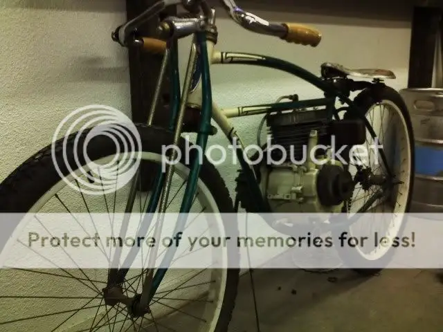

I wouldn't say no one.....I had mine off a year ago for a month or so and was running a Viper temp monitor/gauge all the while. The only time it would get a little hotter was sitting at a stop light for several minutes. On a really hot day I don't think it got over 220deg. while idling for lengthy periods, nothing that would hurt the little powerhouse lol. Here's some pics:

Very nice Scotto, but why only for a month was it off? Just curious...
Thanks.....I'm a slow painter? I did have it off for a re-paint and was testing it as well for any heat issues. You can run just fine without all the cowling unless you live between Texas and Arizona in the summer lol.

Wow that engine looks like it fits perfectly in the Panther frame. Very nice platform to work with, which engine and trany is that exactly?
