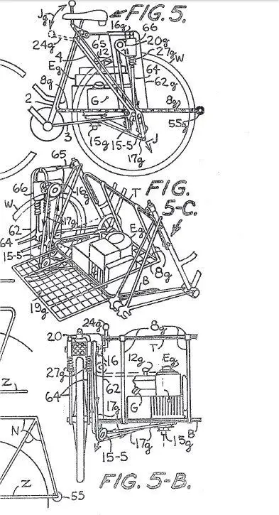

Um..... A lot would depend on how strong the tyre sidewalls were. Myself I think trying to use friction drive on the side of a bicycle tyre with a 3.5Hp engine could wind up with your tyre going bang suddenly.
A vertical shaft engine really needs a twisted or 'round-the-corner' type belt drive in order to work properly on a bicycle.
This old patent drawing shows an example of how to use a vertical shaft engine to power a bike (the drawing is for a sidecar or a quad though so you'll need to make some changes).
