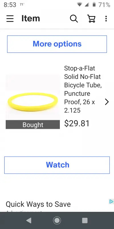

Purchase---+++
https://www.ebay.com/itm/293570594237
Those don't work well. You should have bought a Mr. Tuffy Tire Liner.
I've had one b4.I know there so,so.
One thing I know, taking that back tire on & off...Bites!!!
If I didn't have a spare tube, I would have been SCREWED. I was 5 miles from home...
Was it a Mr. Tuffy tire liner that you had or some other brand like slime? There’s a difference. Those slime tire liners stink bad.
I'm not sure. I know they cause drag.
They make the bike harder to pedal but with a motor I'm not going to worry about that issue. It must fit well tough. I have 30 days to return it.
