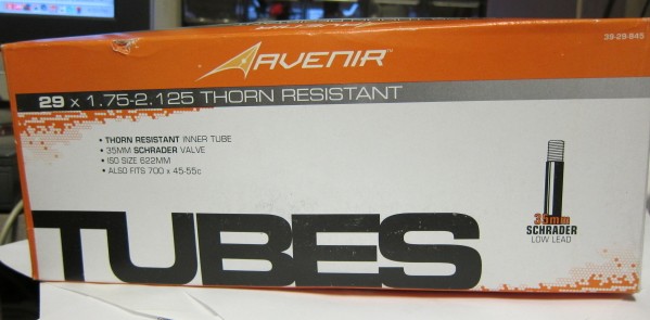

You haven't looked hard enough.
You can find anything on the internet. I got this off Amazon.

Do you have the amazon link for that? I'm curious on how much they would be shipped and the time etc. 26 inch tubes at wal-mart for 5.00 flat no shipping and no waiting seems kinda hard to beat.
