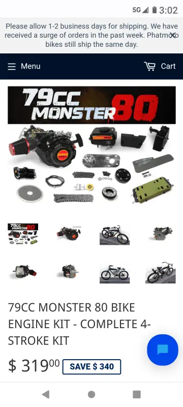

I like the 79cc predator for the parts available for it.. more options for upgrades
