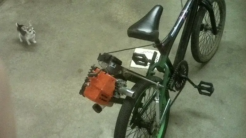

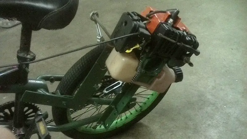

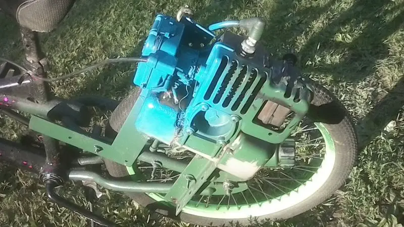

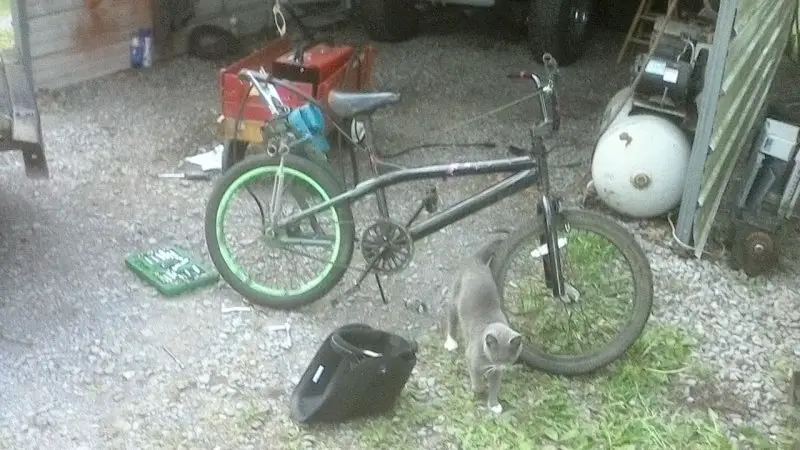

The bike was free and so was the weed eater used angle iron for a side hanging Mount then welded everything so it would never come apart. Pics of this contraption are coming soon. Of course it has no breaks

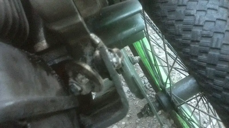

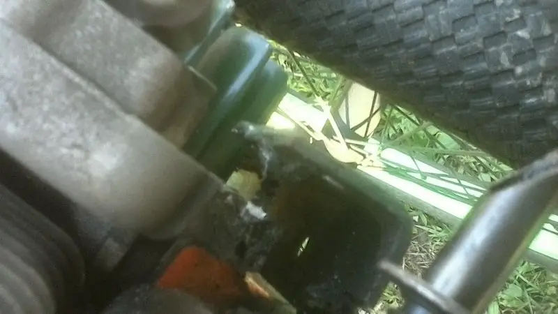

yesterday on the half mile test track three tack welds broke at the same time and the engine broke away from one of it's mounts. Time to break out the welder and stick it back together.

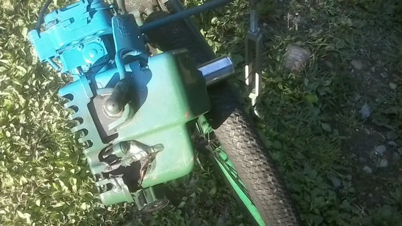

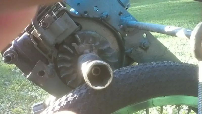

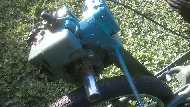

The socket bolted on using the original flywheel nut and washer its just a tad smaller then a bike peg. The engine has great torque for being 25cc

Do you have a way to disengage the engine and pedal?
The engine is hard mounted to just barley touch the tire the turn buckle adds the very little needed pressure and the turnbuckle can also push the engine off the tire. But it has enough power and starts very very easily so having a clutch is not an issue
