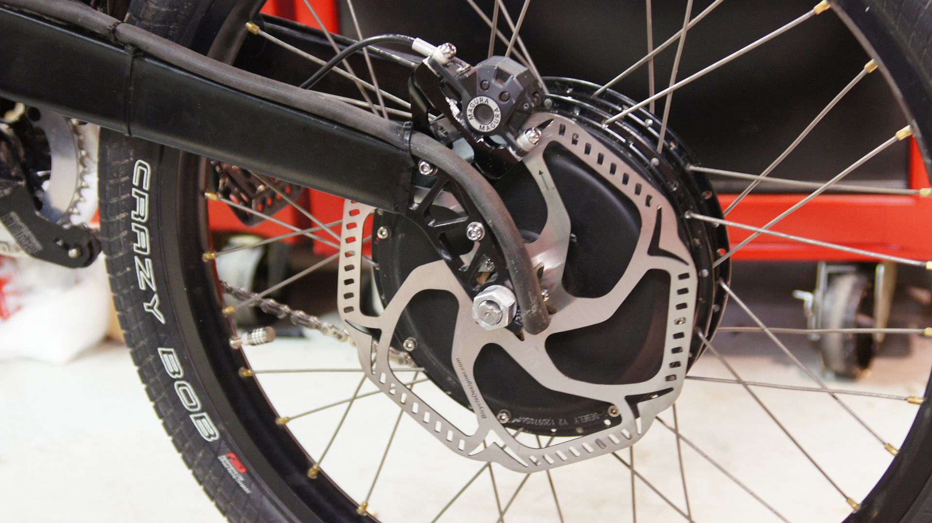

The rotors kept the heat down from high speed braking. But I don't run that fast anymore, so I went back to the 203mm. Whenever I find some proper dual front hydraulic calipers, I'll switch back the 255mm for the OMG factor.
This is what the 255 looks like on the rear.
This is what it looks like on the front.
