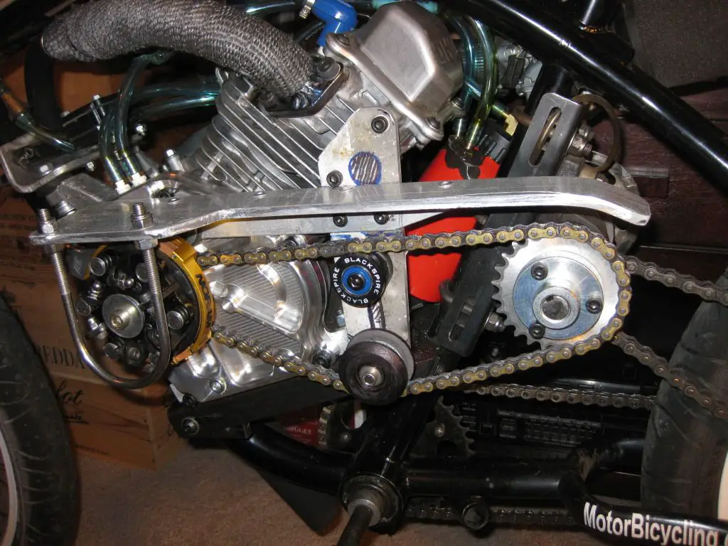

I run a 42t rear sprocket with a 24" rear tire and it just flies! Pretty good take-offs and tops out around 56mph.....
.wee.
Damn scotto,what kinda engine you got in that thing,a deisel?
He has a Pred 212 and AGK tranny, has nothing to do with the OP's setup

I had meant to say "AGK style" but forgot to type "style" lol
That my friend is an original scotto-matic tranny......don't mistake it for those cheap imitations on the market :D The only thing AGK about it is the 26t sprocket and the 5/8" adapter it's bolted to. Scotto-matic*......smooth as glass!
