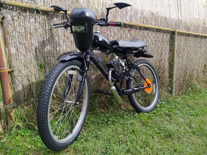

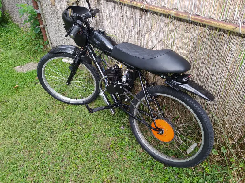

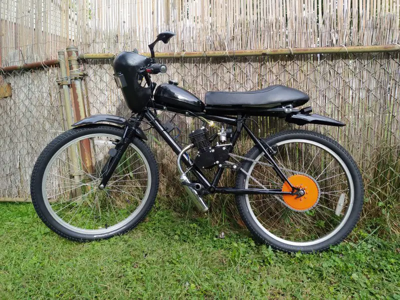

I've really wanted to get into small engines as a hobby, and this is my first build. I bought a cheapy china engine and crammed into this little frame. I bought a cheap cafe racer seat that gave me an excuse to use my 40 dollar stick welder I bought off my neighbor, and fabricated a seat bracket and foot pegs made from an old set of handlebars. I also bought a fender set for a kids dirt bike, and to top it off, made a headlight fairing out of my old crappy welding helmet and a headlamp. Tis a super fun little bike that allowed me some open air cruisin since I have been forbidden from owning a motorcycle. Honestly, the way people drive these days I'm pretty sure I wouldn't want to commute on a 2 wheeler anyways. I've enjoyed the forum so far and hope to learn more from y'all.

Good job the seat and the bug shield looks good But I would of kept the pedals.
It's no longer a Motor Bicycle.

Lol I never even considered that. Man, I'm really not very good at this internet as a social medium. Shot down before I even made it off the runway! :crash:

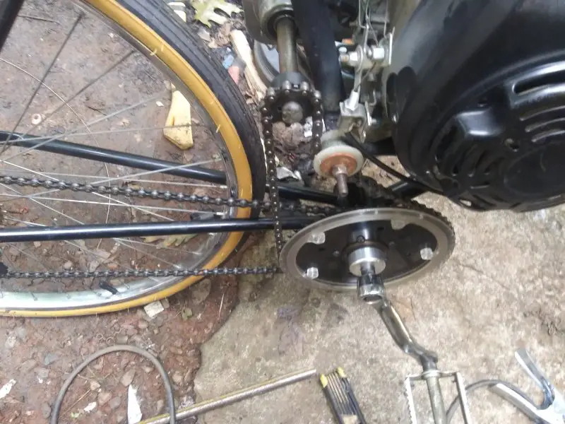

I have their shift kit bottom bracket on my Huffy Ultima build. I used it with a non standard 79cc 4 stroke so all I needed was the bracket and chainring, but they sell kits for the 2 stroke engines and the 49cc 4 stroke engines.
Here's my Huffy to give you an idea of how the chain ring works out. Gives me 6 speeds.
The chain ring has a 1 way bearing so you can still pedal assist, and once the engine overcomes your pedalling it freewheels so your pedals don't spin.

So, that rides the low gear on your front sprocket? Remove or dont use the front derailleur? What size engine, and speed? Seems like even 49cc would haul with 6 gears! Thanks for pics and explanation!
