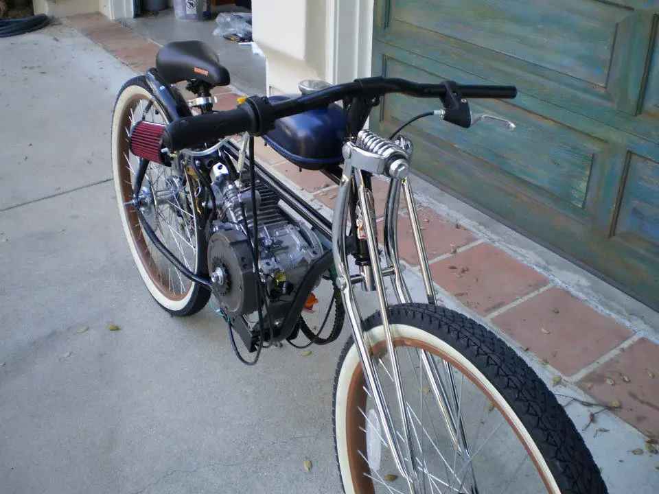

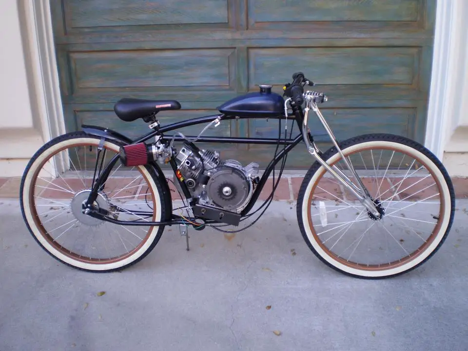

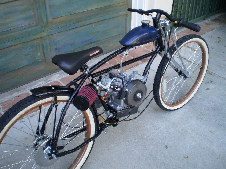

ok so im pretty much done, let me know what you guys think! its the 212cc predator, TAV2 CVT, drum brake, springer fork, custom 1/8th steel motor mount, modified seat post and large air intake! Just need to get flexible hosing for intake, set up throttle, and kiull switch, and most importantly, i need an awesome exhaust!

One things for sure.......you better put a lot more than just a rear band brake on that thing or someone is gonna get seriously hurt on or by it! I'm not joking.....you need some stopping power up front and you have none. A band brake on the rear is useless and that's what you're relying on? Please put some kind of real brake on your bike so you don't live in pain for the rest of your life!
And yer gonna start the engine with a pull chain?
Scary man.....just plain scary.
Thts a Workman frame right? Is there a specific reason tht your sprocket is on the right hand side? Hey Glennbo would 11g spokes &a moped hub sufficient for a 212 preddy? Forgive me I'm still new
beautiful bike man i have the engine on mine, ur bike is gonna be wicked fast(trust me and the cops know). keep working on it, dont stop now. i only got front v brakes, keep rollin dude
Ummm, I hope dude is ok.......he hasn't posted in months. I hope nothing broke with no brakes so to speak.
