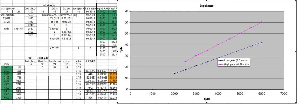

I have 2 jackshafts that'll allow me to run a 2spd auto.
![](/proxy.php?image=http%3A%2F%2Fi195.photobucket.com%2Falbums%2Fz268%2Fmr2_503%2FMBike%2F212%2FIMG_0105_zpsb66bd5bc.jpg&hash=bc005b64e0df32bddf859bdcb052fd73)
Should i go with a low gear and a high gear or stay single speed.
Low gear 9.5:1 for 22.5"tires ~ 11.4:1 for 27" tires
High gear 6.69:1 for 22.5"tires ~ 8.06:1 for 27" tires
~4100rpm is where the second clutch kicks in for high gear, and low gear would just freewheel.
![](/proxy.php?image=http%3A%2F%2Fi195.photobucket.com%2Falbums%2Fz268%2Fmr2_503%2FMBike%2F212%2F2spdauto_zpsf6a02589.jpg&hash=91a9aec4396046fe74b35851e44f29e4)
