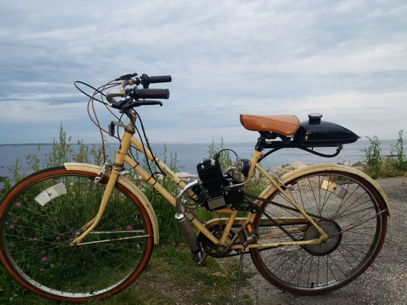

So the problem did end up being a clogged air filter. Loaded with oil sludge. Cleaned that and moved the needle to a more lean condition and she ran great! Thanks for the help everyone... now for the bad news. While on my test ride I somehow managed to run over some rope which worked it's way around my rear breaks dragging them into the spokes causing the rear break caliper to bend severely and ripping out 4 spokes wrapping them around the axle. The bike is from 1970 it's a huffy regatta. Parts are tough to find and the rear wheel is a 3 speed hub transmission. I'm still trying to decide if I want to put the work into fixing this 1970s huffy or just go buy a new frame for this engine. I'll attach a picture of the bike before the damage so we can mourne its loss together lol

I'm glad the engine problem was easy to fix... But bummer about the bike... :(
Unless you can do the repairs yourself?, it might be cheaper to just buy another used bike from your local thrift store or craigslist.
