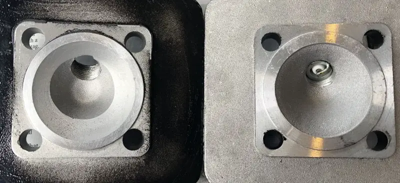

I had some very similar issues to yours with my bike. My jerking issues were solved by using a different head with a smaller combustion chamber. These engines are all put together with rather random parts and seems no two are exactly the same. Changed heads on mine and all problems vanished, that was after 3 different carburetors. See the pictures below with the different heads. The one on the right was the one that made it happy
