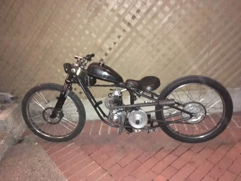

Looking good! Yeah the cvt plates break although it’s technically the best way to do it if they were stronger, have a direct support between driveshafts at the points of driving force. But I never used a plate either… just had the js mount on the back of the engine mount.

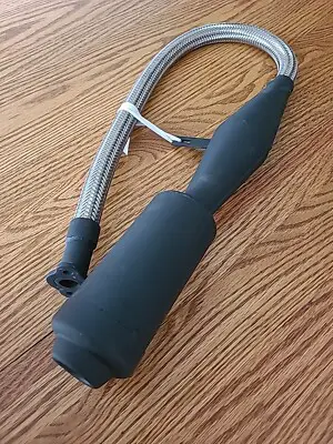

Kinda looking ahead to exhaust options..I am considering ordering this and giving it a whirl..The flange bolt pattern is the same as the Honda Engine.. If you look at the above photo..You will see a hole in the front frame plate..That is where the original exhaust ran through..This just might work great..

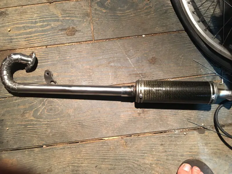

Your setup looks great also..Where did you get the exhaust on yours..Thanks
