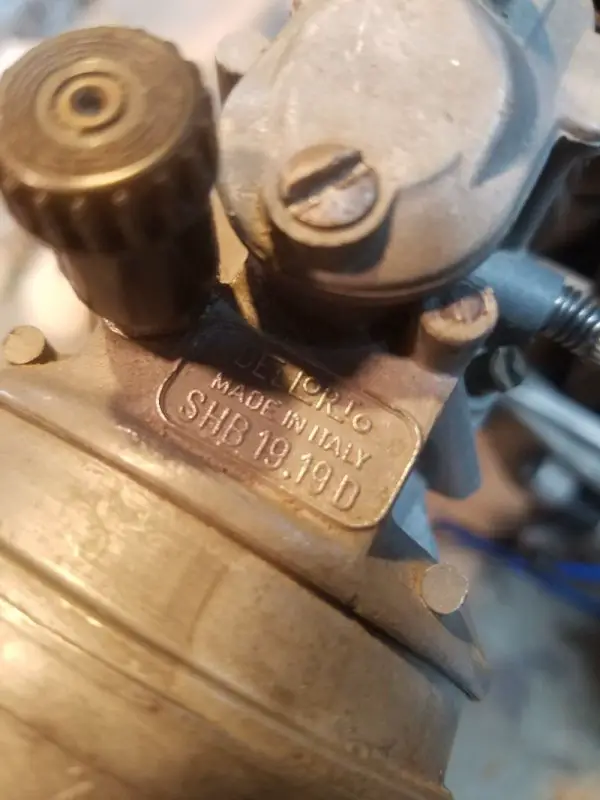

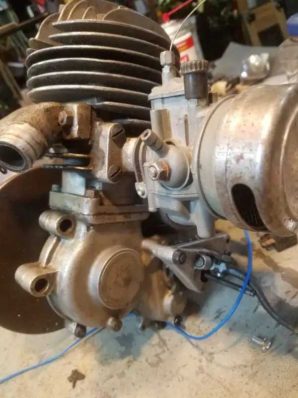

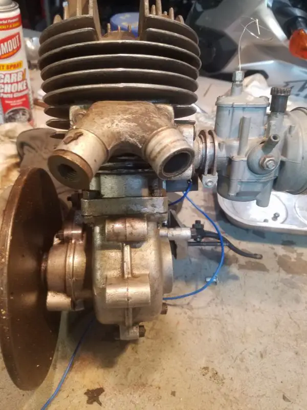

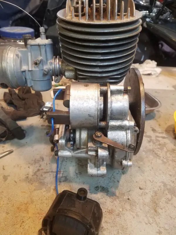

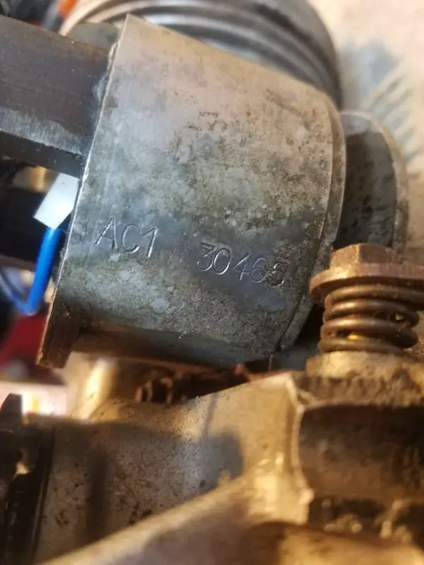

I Bought this COOL OLD Bicycle Engine.
I have been able to determine it is a 1946ish Derby-Zurcher 99cc Bicycle engine.
I see it called a CLIP-on engine..
Thats all I can find..
Can anyone offer any OTHER details please?
I have it on the bench to test.. But I need to know the static timing for the divorced distributor..

Cool motor! Assuming it has points best guess is you set them with the head off and a dial indicator on the piston. Again a guess, but if the points open at 1mm BTDC you should be safe.
By comparison spec on my old 360 is 2.6-2.8mm BTDC and I'd expect a smaller motor to need less timing.
Hope that helps.
