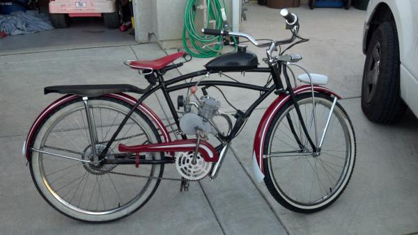

I certainly enjoy the old cruisers with just the motor kit, 4 or 2 cycle and super clean showroom shiny like this one! The way I dreamed they could be when I was ten years old. Cool then and now!
Rick C.
