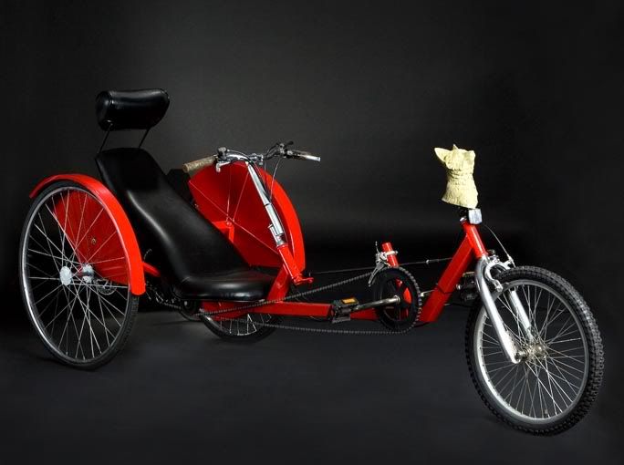

If you guys are thinking trikes you really need to check out Atomic Zombie. How about this for a chengine candidate?

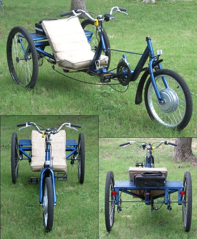

Or this one?

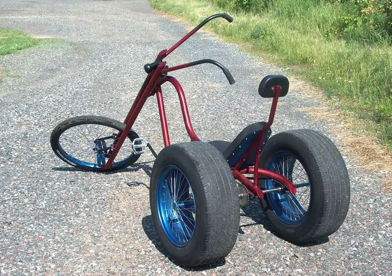

How about a truck type?
These are all easily built from a couple of donor bikes and plans available at the site. No machining needed. Just welder, grinder, drill, etc.
Take a look at the site.

AZ didn't build those last two. Those trikes were made/adapted from his plans.
