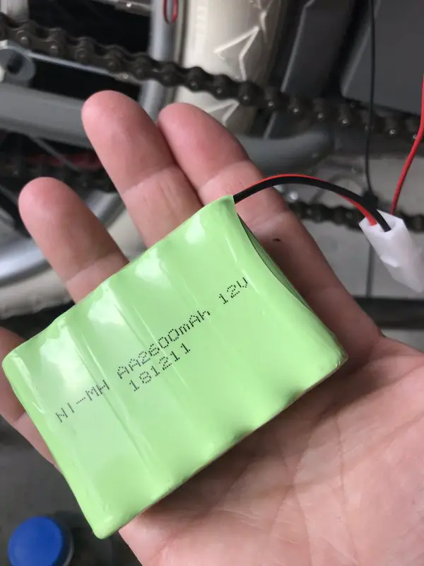

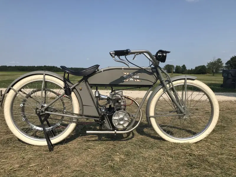

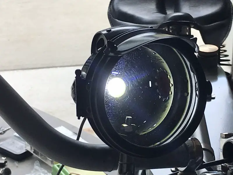

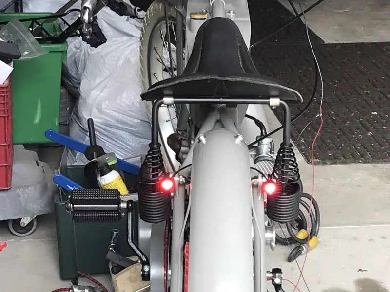

Yepper, I used this little 12v and then just get some 12v motorcycle lights ...run for hrs
