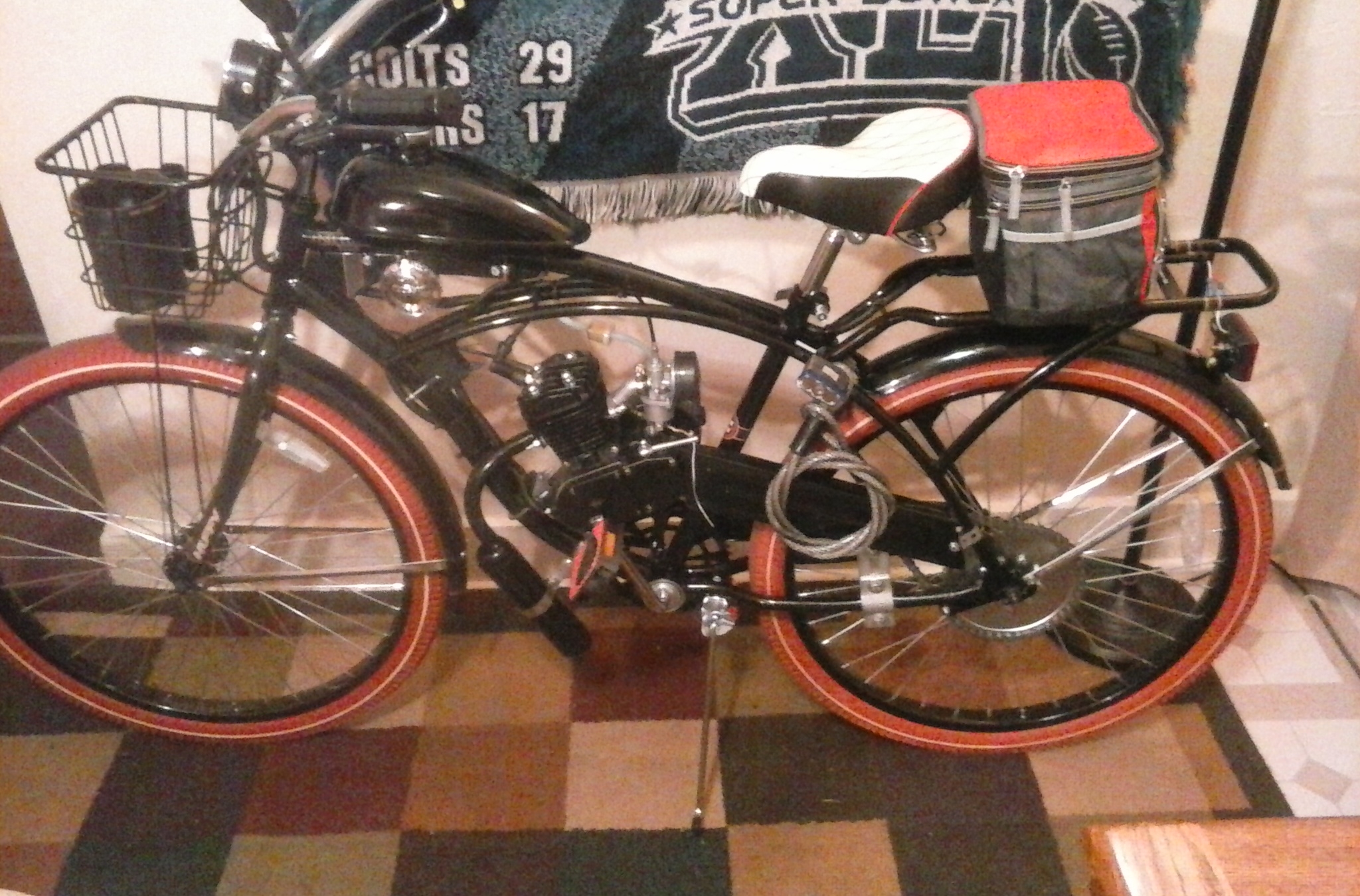

I was wondering if anyone else has had this problem.
Just built my 2nd motorized bike yesterday and when I went to start it, it wasn't easy. Had to keep trying for a few minutes, which is normal, then when it started it felt like it was falling on it's face. I took it around the block and it was sputtering the whole time, like it wasn't getting fuel or it had intermediate spark. I took it ONE WHOLE BLOCK and it died when I pulled up to my house. I tried for the next hour to start it again and it wouldn't start back up. I took the bike inside and checked it for spark. I have spark at the plug. I took my carburetor apart to check for dirt in the floats, I didn't see anything so I put it back together. I took it back outside and tried to start it again. This time it started for about 15 seconds and then died. I gave up for the night. Today I took my carburetor apart again and disassembled it completely. I cleaned it up and put it back together. I took the bike outside and tried again. This time it started up, just like the very first time, and I rode it around the block, sputtering the whole way, never reaching 20mph. As I came around the block and pulled up to my house, it died again. I tried to restart it and it will not start again.
Do I have a bad carburetor? Is my magneto bad? Is my CDI bad?
My kill switch is not plugged in.
I have an inline fuel filter.
My petcock seems to be functioning correctly.
I am using premium gas with the correct oil/gas mixture.
I do not have the tools or the know-how to use an ohm meter. All I know is it does have spark. It did run 2 times for about 120 seconds each time.
I ordered a racing carburetor today. I am hoping this fixes my problem.
Should I order a new CDI and magneto too?
I have $432.00 in this bike already. A new CDI and magneto will put me at $450.00.
