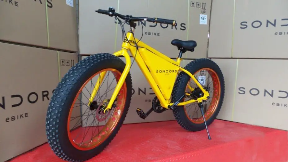

It's based on a Sondors eBike (Pacific Storm inc). When this bike first came on the scene last year, it was billed as the worlds most affordable eBike. The total cost for a complete Storm eBike was so amazingly low compared to the competition, it caused a massive disturbance in the force, and instantly became a sensation in the eBike world which is still ongoing. I paid $693 shipped to my door direct from China. This price is comparable to my first china girl build.
This is the basic bike as it comes out of the box. Perfect for a beginner, and also perfect for advanced builders like myself.

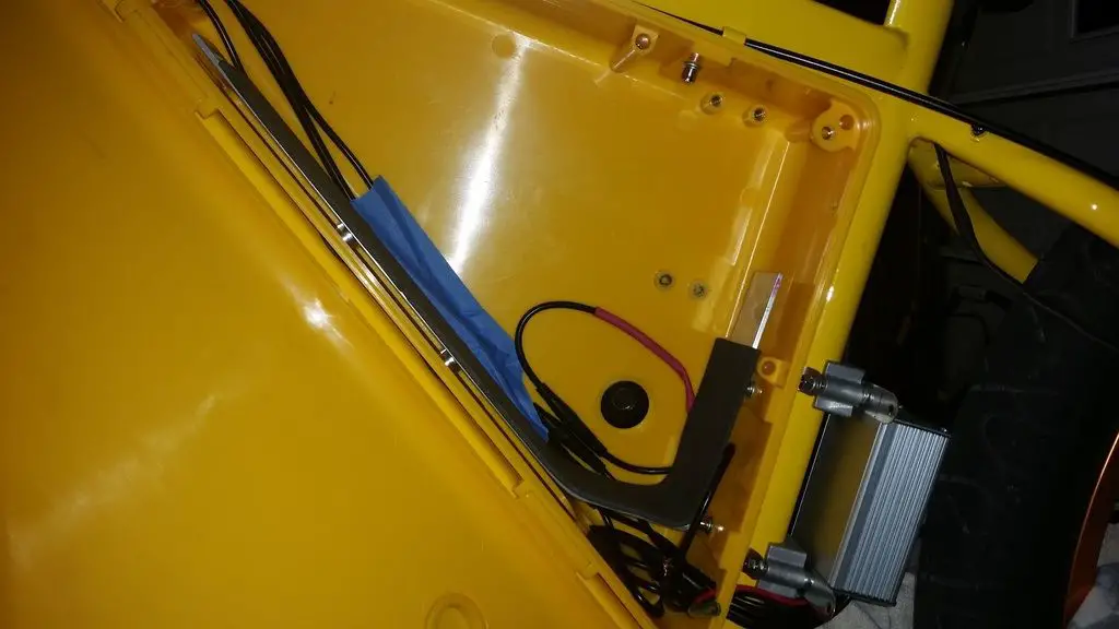

20 amp controller relocated outside the battery box. Stock is 15 amp

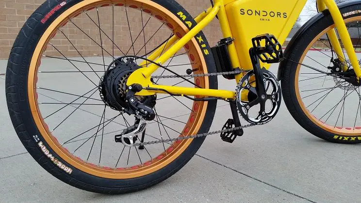

3 speed freewheel 16/19/22T. Bike comes with single speed 16T freewheel.
170mm crank set for square taper spindle w/50T sprocket. Stock is 40T

In order to mount the big triangle battery it was necessary to fabricate a frame mounted platform to keep the weight of the 15lb battery off the plastic box. This battery used all the available space in the box so it became necessary to relocate the controller to the seat post tube on the outside of the box. I used a pair of china girl rear motor mounts for this purpose. The lights came with no mounts so it was necessary to fabricate a custom headlight mount. The taillight was easier, I just wire tied it under the seat. I custom mounted and wired an illuminated button switch, drilled into the plastic box to control the lighting. Converting to a 3 speed was actually pretty easy. I only needed to spread the drop outs 1/8", and add a thick washer to accommodate the 3 speed freewheel. Although you can buy special hand grips for Grip Shifters I customized the stock grips with a hacksaw, and sharp knife to fit. I also had to custom fit the fenders, but about all that involved was fabricating custom stays, and a couple of brackets.

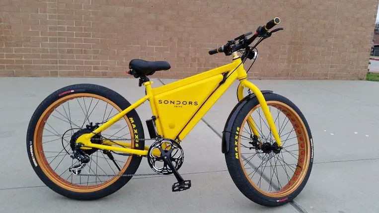

Now I have 850w and can pedal assist to 28 mph which is top speed with assist. Range is now greatly improved with a full throttle no assist range of 35 miles estimated, a 20 mph cruising speed range of about 80 miles. Cruising at normal bicycle speeds, range is estimated over 100 miles. I use a 5 amp charger which charges a fully discharged battery in 6 hours, but this huge battery seldom takes more than 3 hours to charge.
The bike now has throttle, 5 level pedal assist, and electronic cruise control. The throttle is always active, and overrides the other modes. There's zero vibration, and relatively quiet operation. In over a 1000 miles I haven't experienced one single mechanical, or electrical failure. Total cost to date is a little less than $2000, which is a few hundred less than my most expensive china girl build, which was Stunner.
I named this bike Fatty

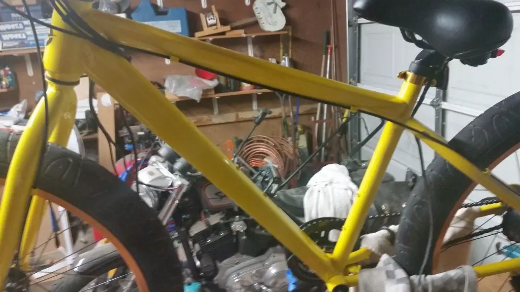

And so it begins
In this picture you see the platform I made to support the battery. It's important to keep the weight of the battery off the plastic box. It mounts to the fame down tube through openings in the bottom of the box. You'll also recognize the china girl motor mounts I used to mount the controller to the seat post tube.

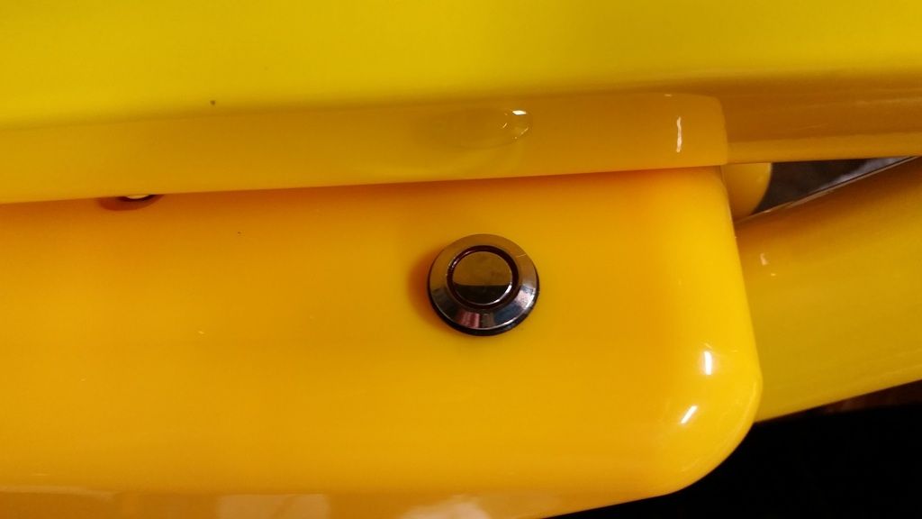

This is the button switch I installed to operate the lighting which is hard wired to the main system power. A big advantage over a typical china girl, because it allows very powerful lighting.

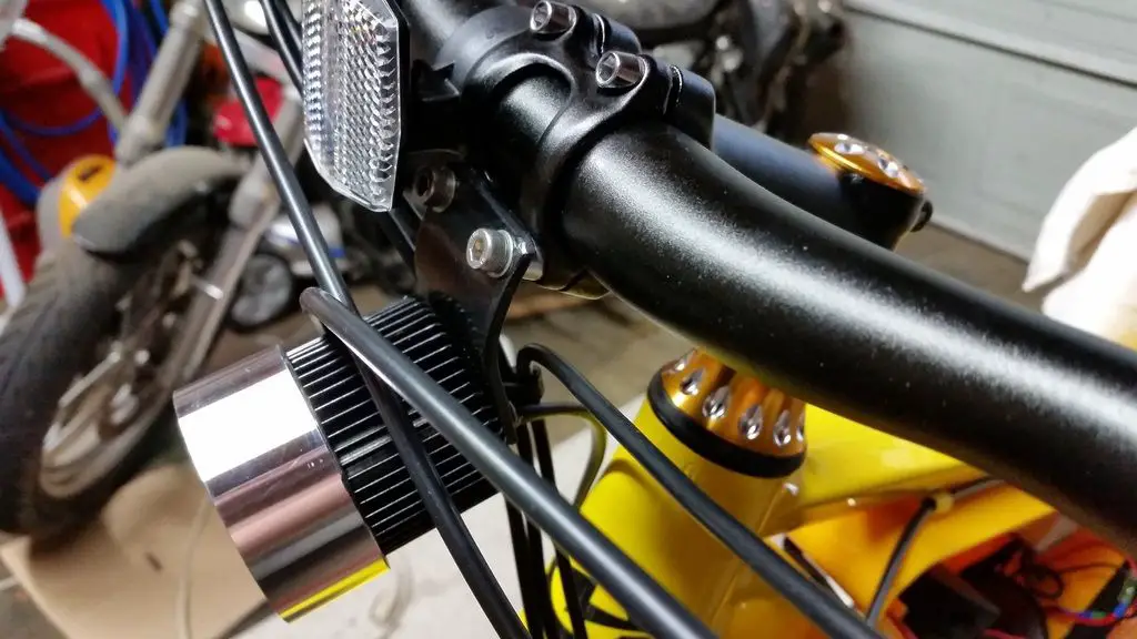

This is how I custom mounted the headlight. It's aimed low, and it's not adjustable, but that's ok, because it's so bright it has to aim low to not blind oncoming traffic. I still get flashed on occasion.
This is a view of the handle bar controls. See my custom modified hand grips cut down for a Grip Shift, and half grip twist throttle. I had to use a 7 speed Grip Shift which is designed for the right side. It had to be mounted on the left so the numbers are upside down. Since I only have 3 gears the derailleur is adjusted so that twisting the shifter past 3rd gear causes no further movement to the derailleur, so there's no problem with the chain jumping the sprocket. The red button turns the controller on, and off. The KT3 LCD display offers a lot on useful information about battery level, road speed, trip meter, hours of operation, real time watts usage, ambient air temperature, and level of pedal assist. The 3 button switch on the left adjusts the pedal assist on the fly.

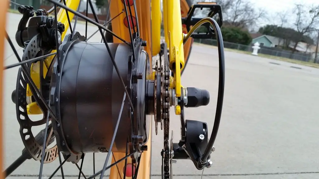

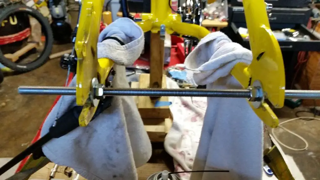

I stretched the drop outs 1/8" farther apart to accommodate the wider freewheel. This is an easy way to stretch the drop outs if you ever find the need.
This is a view down the chain line.

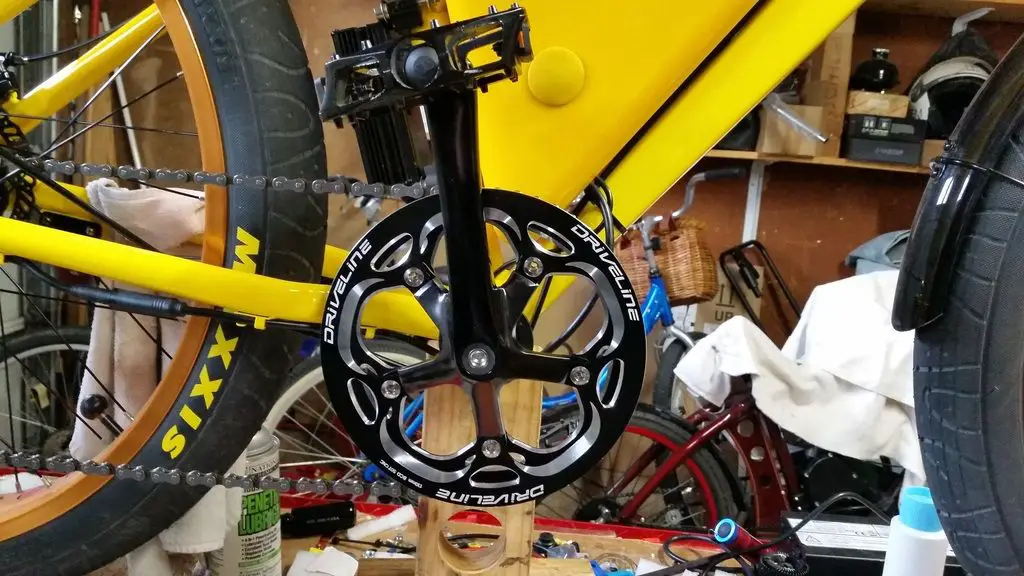

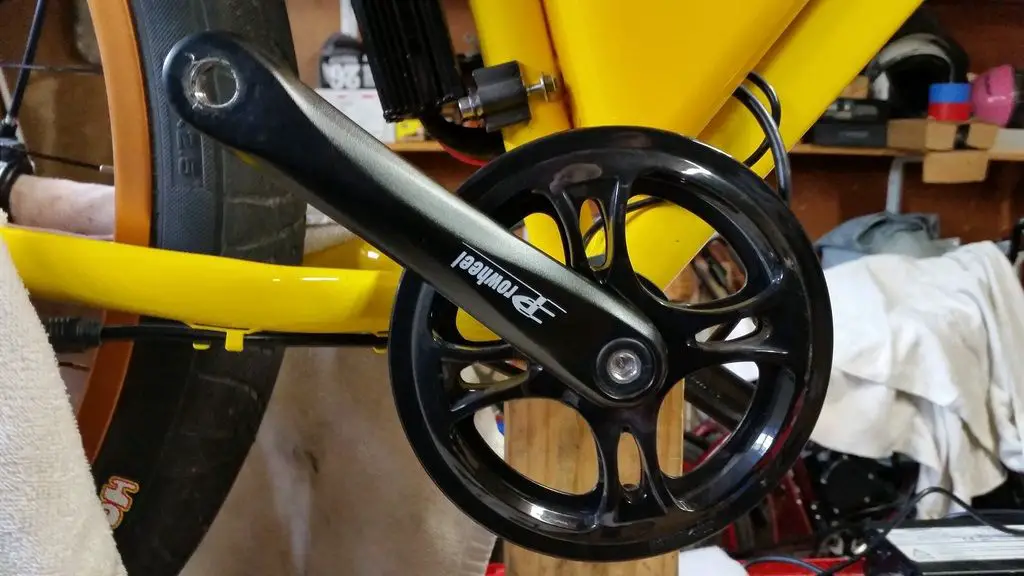

Here's a comparison of the stock crank set, versus the new 50T. Believe it of not the entire crank set was only about $70. That price included a 40T sprocket, and sealed bearing BB that I didn't even use.
The crank arms, 50T sprocket, and guard were purchased separately.
