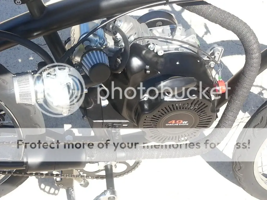

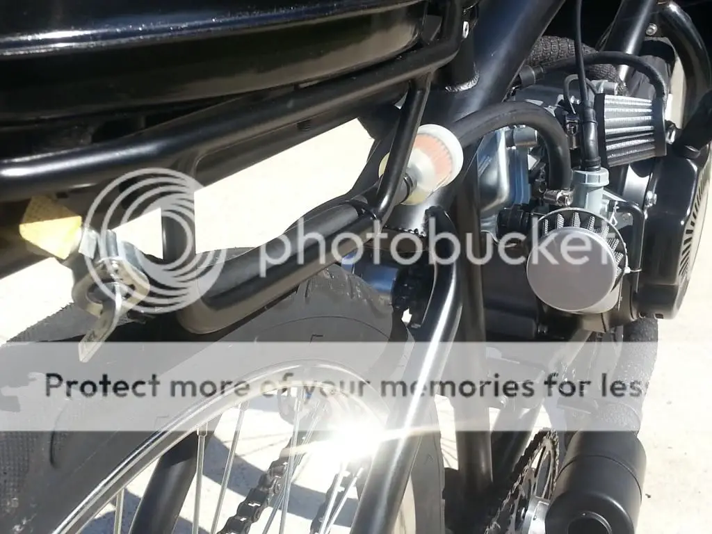

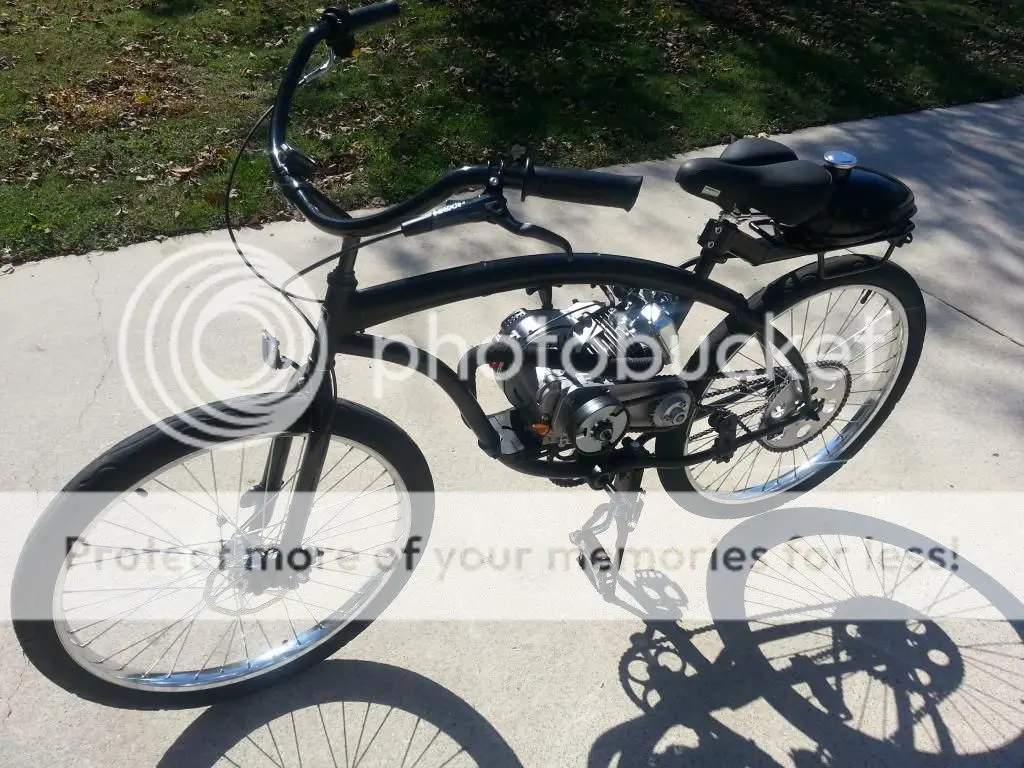

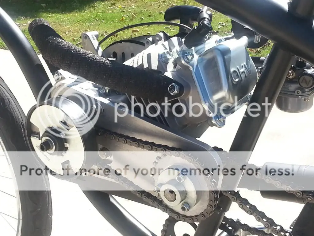

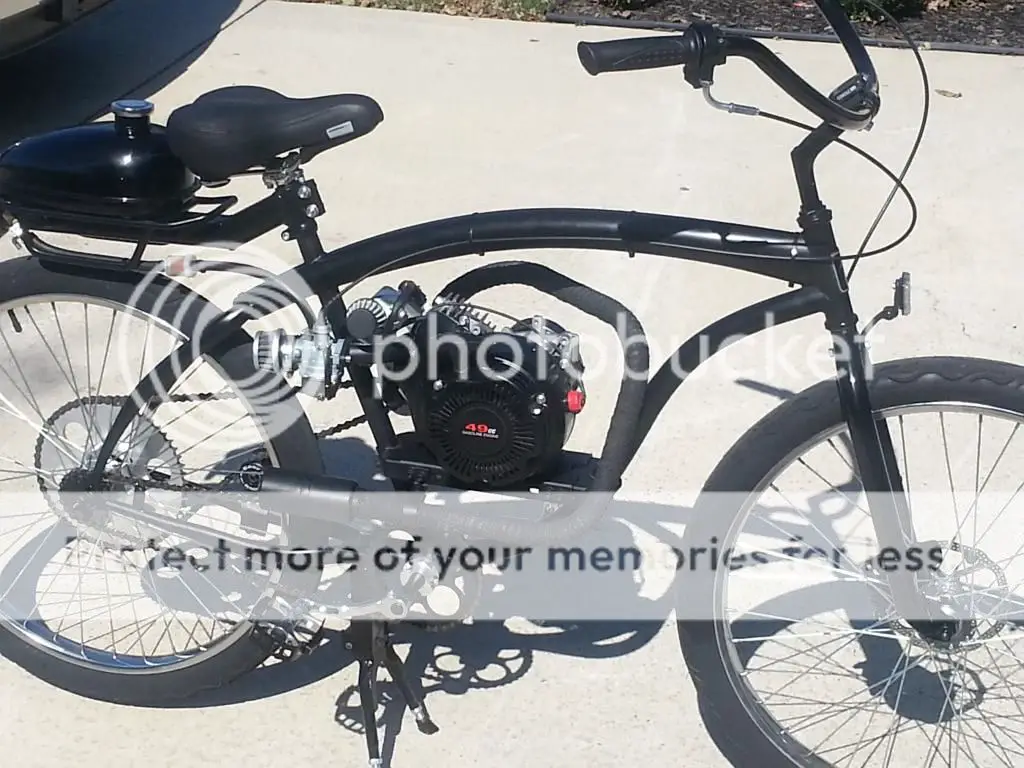

This is my Firmstrong bike that used to be my 2-stroker. I live in a very hilly neighborhood so I geared it to do about 30 on the top speed. With the pipe, 19mm carb, and gearing it has no problems going up any hill in my neighborhood around 22 to 25 mph.
19mm carb., Intake, exhaust, engine mount, Jackshaft, and clutch came from AGK.
http://www.affordablegokarts.com/mm5/merchant.mvc?Screen=CTGY&Category_Code=MTRBK79
Wheels, crank assembly, 49cc sticker, and 56 tooth rear sprocket came from CustomMotoredBicycles.com
Wheels:
http://custommotoredbicycles.com/sta-tru_heavy_duty_bicycle_wheels_26_inch_x_2125_assembled_in_usa_better_chrome
Cranks:
http://custommotoredbicycles.com/wide_bicycle_pedal_crank_sets_for_clearing_4_stroke_motors68mm_bottom_bracket
Front disc forks came from BicycleDesigner.com.
http://www.bicycledesigner.com/bike-parts/bicycle-forks/26-rigid-forks-with-disc-brake-mount---black.html

I am currently knocking around an idea for a crossover jackshaft so I can add gears. I am waiting on some parts to come in so I an take more measurements.
