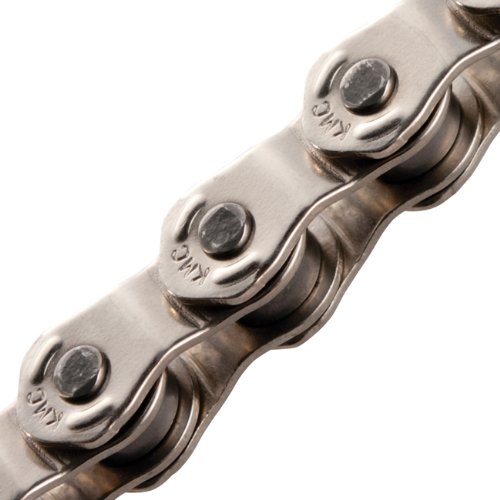

After some test rides I changed the drive a bit.
This mule has so much torque it took out HD Z410 chain twice.
The engine side has 415 but I can't use it on the right side, it's too wide where the chains cross.
I did some checking and found some KMC HL710 1/2 link chain.
I have tried it in the past and hated it but these new ones have a pretty easy to use cotter pin master link which is just a peg as every link is self contained.
This stuff is double tough and easier to work with these days.
Look mom! No Tensioners!
