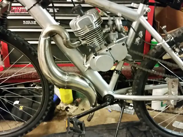

Those are really cool looking and would make a nice platform for a build, the only issue I see with them tho is the small frame will make installation a bit tricky... not impossible, but tricky like needing some minor cutting and fab work. I did my mountainbike with a 66cc engine and it has a small frame, but not quite that small and there's very little room for the engine so I had to do some fab work to get my engine to sit in the frame the way I wanted it to, it was a tight fit but I got it in there and working, but these frames look even smaller... Here's mine for comparison and you can see there's almost no room behind the carb and I had to get a special intake duct just so I could use an air filter... but it was worth it in the end.
Here you can see it's a tight fit, what you can't see well is the mount tabs on the lower tube that the engine bolts to... Also notice the lack of clearance for an air filter... I fixed that problem since this pic was taken, but this will give a basic idea of how tight the clearances are in a small frame bike.. I really like those fat tire bikes tho and may consider one for my next build anyway...

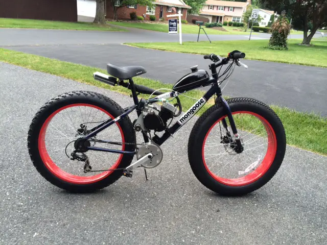

Hey maniac - here's a Dolomite that I did with a SBP HD shift kit. The engine barely fit. I had to tap wider holes in the front mount to make it work because it wouldn't fit with a plate/u-bolt adapter. Other than having to buy a longer 5/8" shaft and fabricate a longer arm for the chain-stop, it pretty much all worked out fine.
It's the bicycle equivalent to riding around in a tank. I love climbing hills & riding wheelies around in the dirt in low gear. It takes a while to get up to speed, but it's actually pretty fast.

Oh, forgot to mention that I did have to buy a lower profile rear tire. The stock one rubbed the jackshaft-to-engine chain & it would have eventually been a problem. It's another "barely fits" item on this bike, but it works just fine.
The disc brakes are actually pretty good. They squealed a lot in the beginning, but they are starting to be a little quieter with some use.
Nicely done! I would have never thought a jackshaft would fit without mods!

Hello Bruza, hey I like your Mongoose Cruiser. Can you post more pics of the front sprocket assembly. I'd like to see how the chain is connected from the motor down to the pedal sprocket.

Curtisfox: it's worth more than $50 to have front & rear discs & the 7 speed shifter. Coaster brakes only on a motorized Beast is just plain stoopid. May as well take the coaster off & just drag your feet. Besides, the Beast's frame is a tighter fit for an engine. I don't seven know if you can squeeze one in there without cutting, welding or offsetting like crazy. The Dolomite is tight, but it can fit with simple mods.
wicker:Bill: I'm out of town right now so I can't post any pics. It's a shift kit from Sick Bike Parts that connects the engine to the pedal's chain. The setup is commonly referred to as a jackshaft.

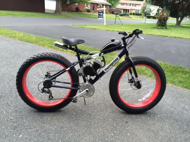

Is there any way you can post a pic, or elaborate on what u had to on the front motor mount?

hey Dave did u do that chamber yourself, looks really nice
