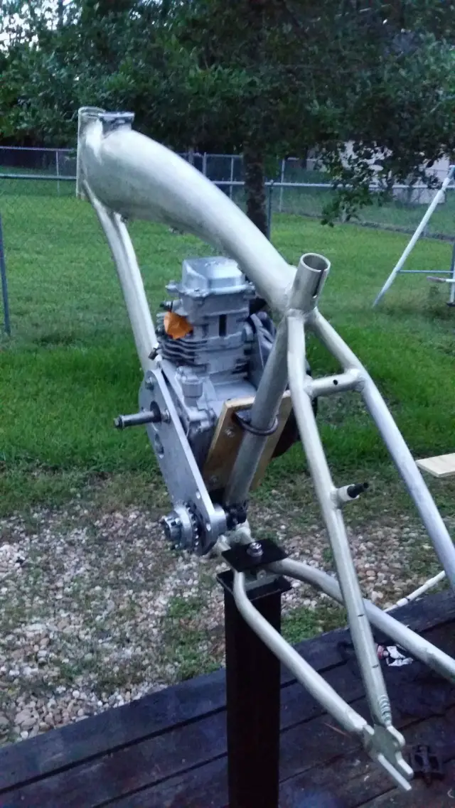

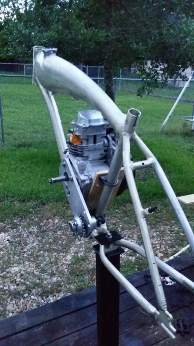

I'm gonna mount the engine vertical. So, last night I made a wood template of the engine mount and used some exhaust clamps I had lying around to mock it up. I believe it is going to work. This was just a rough mock up, but once I fine tune everything...I will transfer the wood template to aluminum plate and will be using billet buggy clamps.
curtisfox
Dec 29, 2008
6,048
3,960
minesota
Wow! That's looking realy good. Yep wood first a lot cheeper the aluminum to make mistakes in ............Curt
mapbike
Mar 14, 2010
5,502
109
Central Area of Texas
Gonna be a nice-un.... keep up the good work.
Map

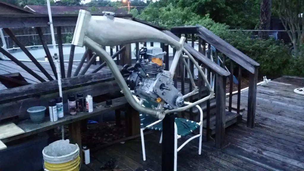

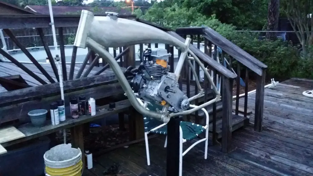

My build hit a snag.....I need a 56t drive sprocket that will fit a top hat adapter and a 41 chain! I bought a 54t for a top hat adapter but it doesn't fit a 41 chain. That's my fault for not asking......
runnermike
Nov 18, 2012
936
16
Sanford, FL
No...you're not blind. I did remove one. I will be running a rear disc brake. I kept the one because I will be running my exhaust that way and will use it has a bracket to brace the exhaust....or at least that's my plan. Lol
